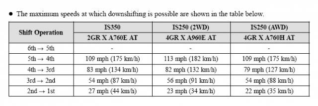

Oh, and for those of you afraid to shift into S-mode while driving for fear that you might be going too fast, don't worry. Following is the logic programmed into the gearbox:
As you can see, unless you're going insanely fast, you won't be hurting the transmission. Max speed for downshifting into 4th gear is 109 mph.
