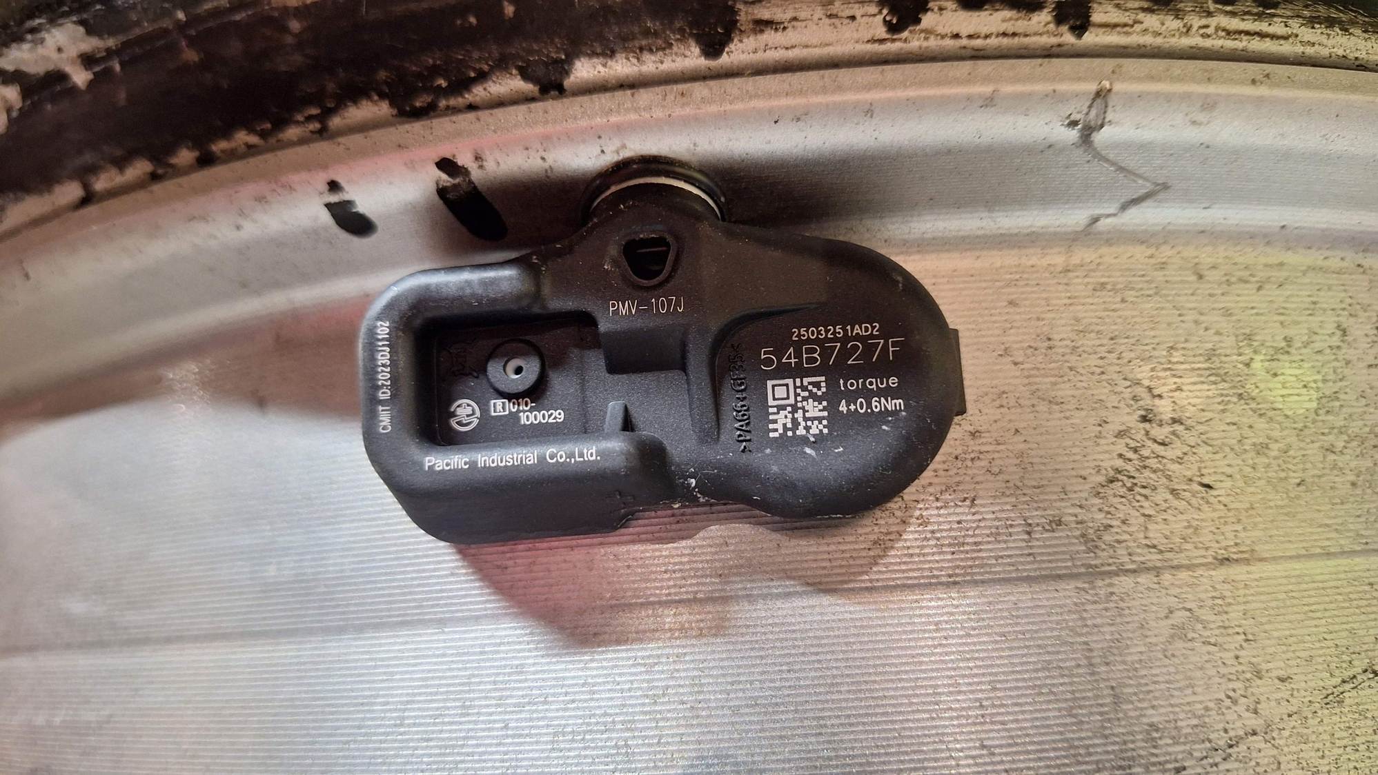

An avoidable mistake occurred here -- the TPMS sensors have a 7-digit hexadecimal code on the back, and you must take note of these codes before installing the sensors.

Just make sure you write down the sensor IDs (or take a picture of them all). Here's a picture of one of my sensors, the ID is the 54B727F number.
Sensor with ID 54B727F
