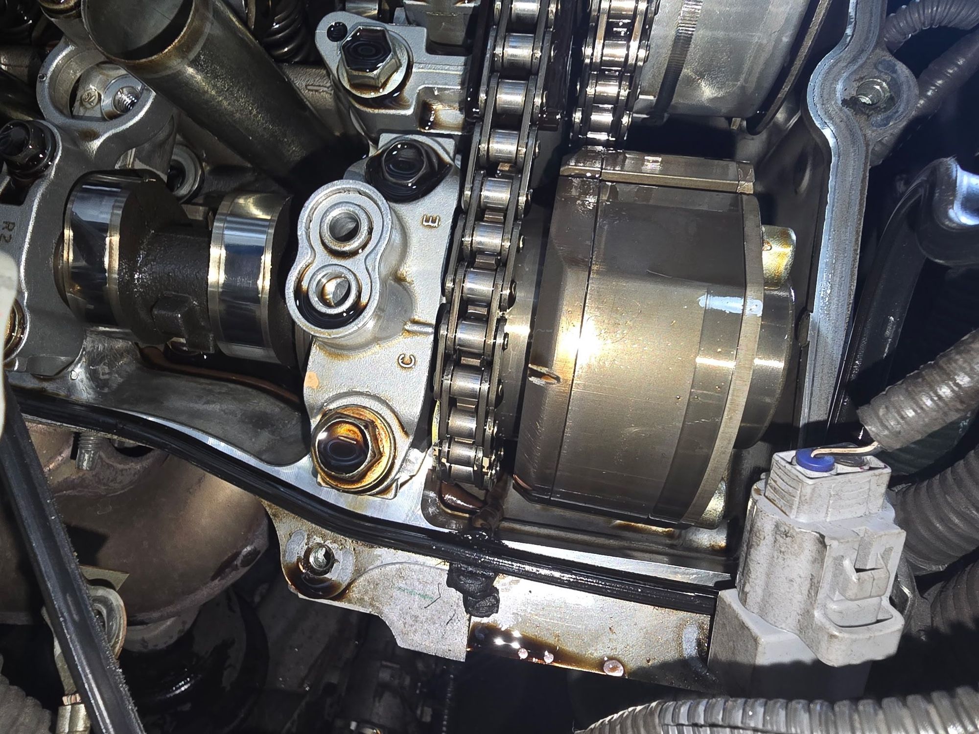

I still have the misfire issues on 1,3,5 and looks like it's timing issues. Timing is off 1 tooth on primary chain. Have you or anyone ever experienced that?
What are some different ways to adjust that 1 tooth off?

May 15, 2025 | 09:04 PM
Quote:
My friends shop took off the valve cover. Anyone see damages or weird wear marks. Thx again for all the help guys 🙏

This video was helpful when I changed head gasket few weeks ago.... Look also how marks on the VVT gear marks (1dot and 2dot) at the back of the VVT gears (intake gears only) matches to markings on both banks, Bank1 and Bank2.... And just what confused me after initial main timing chain replaced was that the main timing chain "colored" marks most likely will not match on VVT gear markings if the main timing chain is replaced (new or old one). Right after if you turn the crank manually from the crank bolt, "colored" links most likely do not match to the markings.... There will be only certain times when they match again with both VVT gear markings (both banks) AND the crank marking (if I have understood timing correctly).
