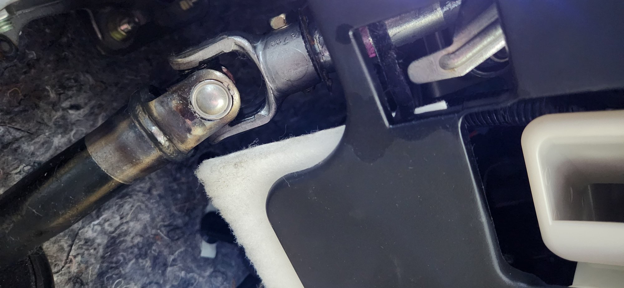

Then I find it. Another contributor. The universal join in the steering column. Located between the steering wheel and the brake pedal (inside the cabin not the engine bay). As I sit in the car, engine on (steering unlocked), in park. Wiggle the steering wheel left and right until there is resistance. I found almost an inch of sloppy steering wiggle followed by a faint "thunk thunk thunk" sound that kept in time with the wiggle. I have yet to swap the part. Attached videos of universal joint in steering column with sound. I would like to swap to the ISF steering ECU, but want this problem resolved first. Hope I do not need to swap the entire steering rack and this u-joint replacement will solve the issue.
view: under steering wheel

OP - lift the cars nose so you can access the pinch bolt on the shaft at the rack. If it can be turned in place where it is with ratchet, tie the steering wheel to the brake pedal so it can't turn freely.
Unbolt the couplers, if it can be removed, pull it but you might have to unbolt the R&P.
Tying the wheel in place will save the clock spring from being damaged.

Each part I swapped helped reduce the issue, but is still present. Have not yet swapped the steering column u-joint. I believe this is the main culprit in my case.
When are you experiencing the steering play? All the time? Have you checked your alignment? Do not accept toe out alignment - neutral or toe in only. Did you swap the lower control arm bushings (LCAB) for a stiffer version (Figs/RR-Racing)? This helped with some bump steer and steering deflection under hard breaking. Particularly when breaking hard while going down hill, increasing weight transfer to the front and exaggerating the control arm bushing flex.
With the car parked, can you wiggle the steering wheel side to side freely with either a tactile or audible "thunk" before feeling turning resistance? My wheel wiggles freely about 0.5in side to side. Think of the old Ford Broncos with the loosely machined steering box, but not quite as bad. This is because of my bad steering shaft u-join
I currently have a list of items to refresh the steering & suspension. Suspension is still original OEM everything with almost 175k miles (excluding sway bars and LCAB)

From the steering wheel to the rack there should be absolutely zero play in any of the joints. If any play is found, replace intermediate shaft and/or joint in tilt column. The steering column has the angle sensor, the rack the assist. Any loss in angle detection/feedback is going to make an I'll driving car. Braces, LCAB, and/or lowering is not going to fix this type of issue.
Source - former alignment tech

Did you ever install the intermediate shaft? Having the same sloppy feeling in my steering and trying to narrow it down as well.
