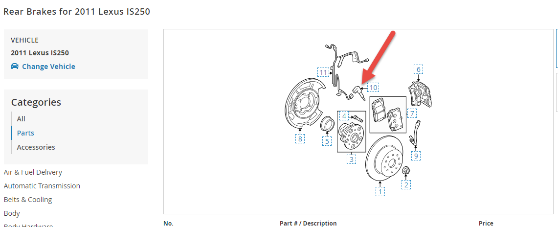

From the looks of it, the sensor has the clip on it. I'm hoping that the sensor\clip is all that is needed to be removed and is plug in play at the sensor...
https://imgur.com/a/s0I4ZYv
Yes that's what im seeing on RockAuto as well.
Has some other work been done to it? These sensors really don't fail that often. Axle and bearing work is known to take a toll if done incorrectly and after that it's wire damage.
Are any of these a factor in your case?
