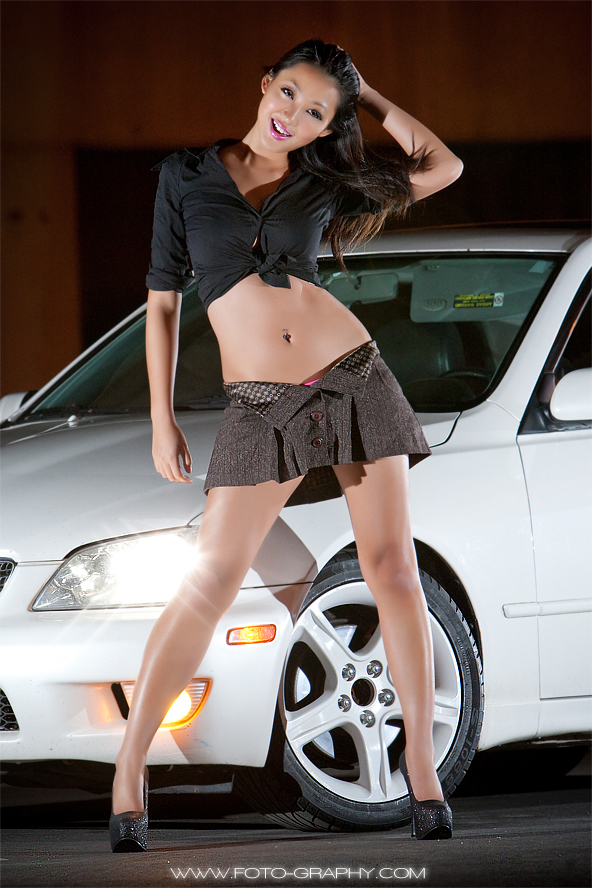

Powdercoating is definitely the way to go.
But if you want to do something cheap and SOON you can rattle can paint them. As long as you take your time and do it right you will get great results. I sprayed mine last year and they are still decent, my only problem with spraying them is that after a year there are some chips in the paint. But that's ok I don't mind spray painting them again..
here is the best/closest shot I have of the painted rims.
sorry the girl is standing in the way though..

wow looks great! how did you go about painting them? what did u do to prep them for spray paint?

looks good!

My technique for painting is
Originally Posted by llllllllll
#1 - Scuff the rims up pretty good with really gritty sandpaper. (this removes all the dirt and grease built up on the wheels & makes a rough surface for the paint to grip better. Don't be scared, scrape the crap out of your rims, the more scrapes the better your paint can grip on to something.
#2 - Wash the dust off with a hose & let dry for 10-15 minutes then wipe down
#3 - Mask the tires off really well with tape and newspaper so you don't have colored tires....
#4 - Spray 3 or 4 light coats of paint, giving 1 hour interval curing time between each coat.... I used the high temperature engine paint. You can get it at pepboys/autozone for like $5 per can. You will need 2 cans for 4 wheels.
#5 - Spray 3 or 4 light coats of clear coat, giving 15 minutes interval between coats. Be sure you get something high temperature
****Don't spray on too thick, thick parts & runs will have yellowish tint****
#6 - sexy wheel time!!!
I think, if you wanted the paint to be a little stronger, after step 4, wait a day or two to let the paint dry really well, then scuff the paint up with some finer grit sand paper, wash them, then apply one or two more coats.
This also works if your wheels have dents, dings, and imperfections, or if you were sloppy and made your paint runny & paint drips.. By sanding the rough paint area (that has already hardened for a day or so), smooth you can kind of "erase" the screwed up area.. Then continue by doing another couple coats of paint, then go to step 5.
Basically, the more time you give the paint to dry the better off you are, and multiple coats of paint (not one thick runny coat), is a good idea too.
It's definitely fun & easy to do if you have a day to waste.

i didnt even notice your car in that picture...

Beautiful, both the girl and the car

haha ilike the wheels, did you paint the center caps too? and the girl ahhh, haha getting side tracked here. are those Nexen tires?
look like yokohamas. Do you even know that girl llllllll? And if you say shes your girlfriend im gonna hate you for life lolz j/k

i looked them up they are wanli tires, haha and i wish i knew that girl in more ways than one
