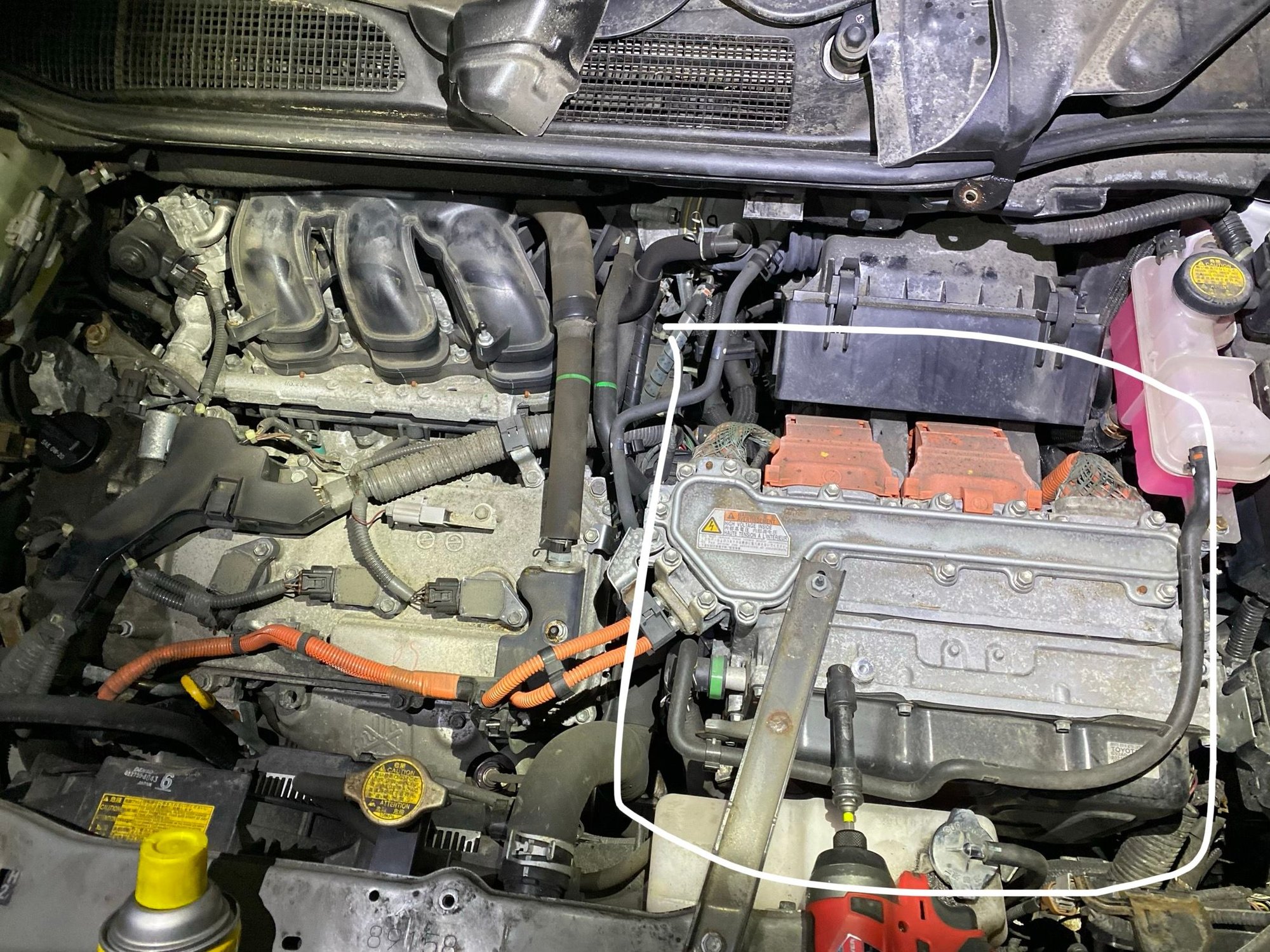

Can someone help with a pic of their engine bay with cover removed?

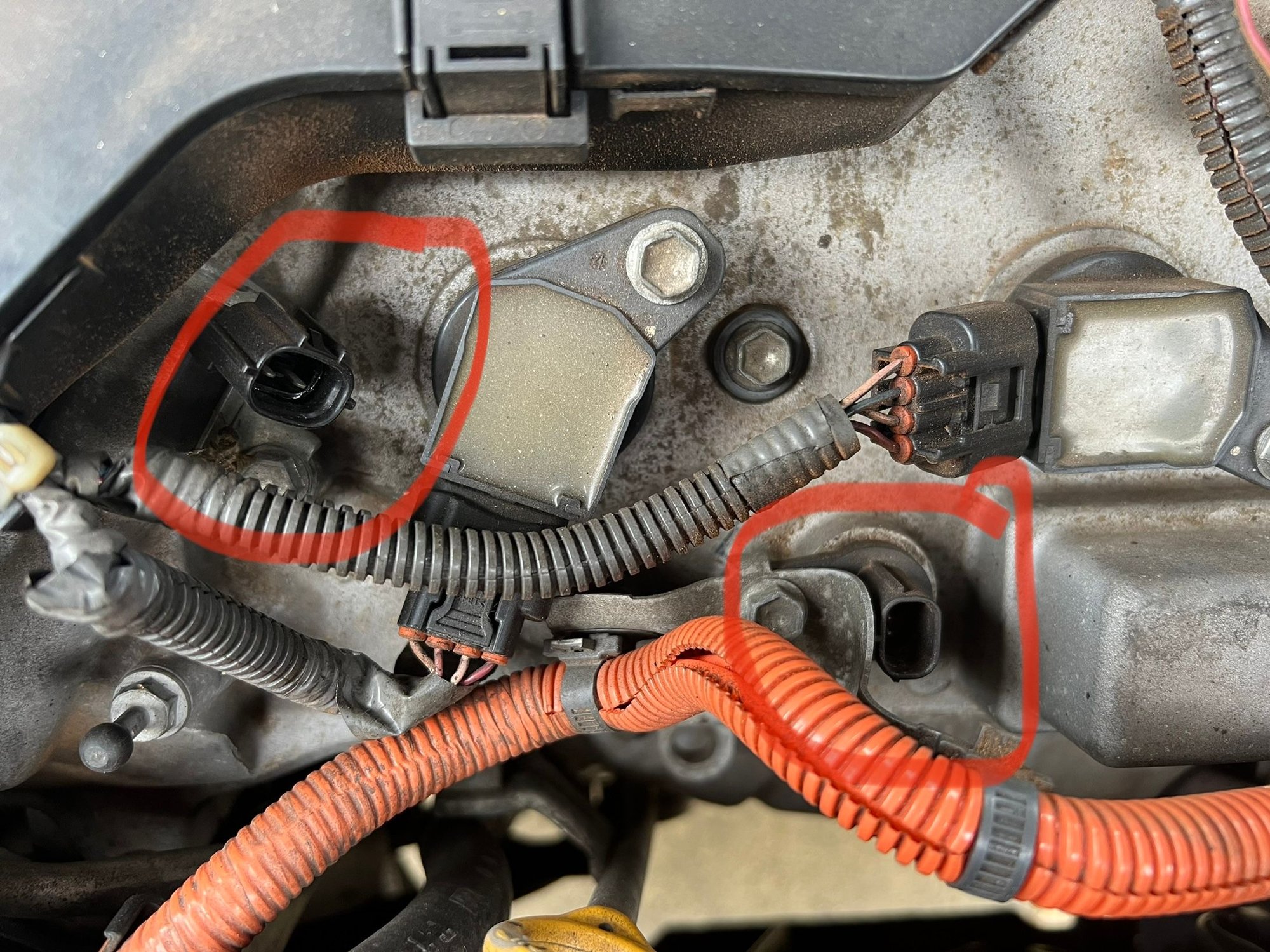

looking at a RX450H engine bay and notice there are two plugs on the cam cover are missing, try to trace it back to the loom.
it seems someone replace a different loom as there are few screws aren’t done properly
car had front end repaired
Two plugs missing connectors

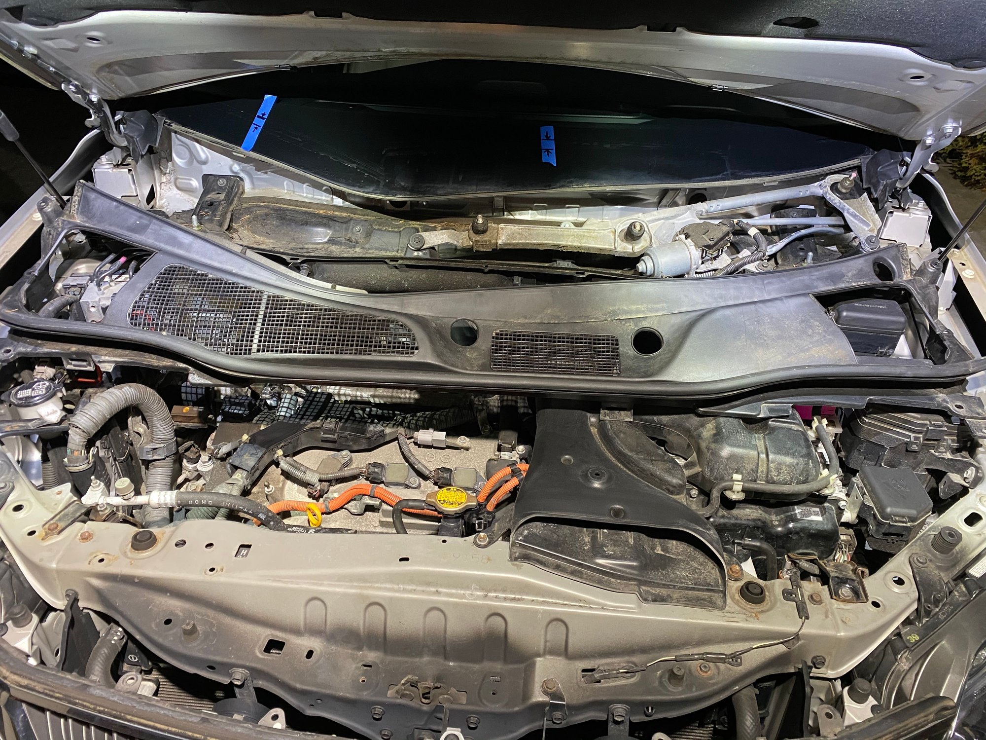

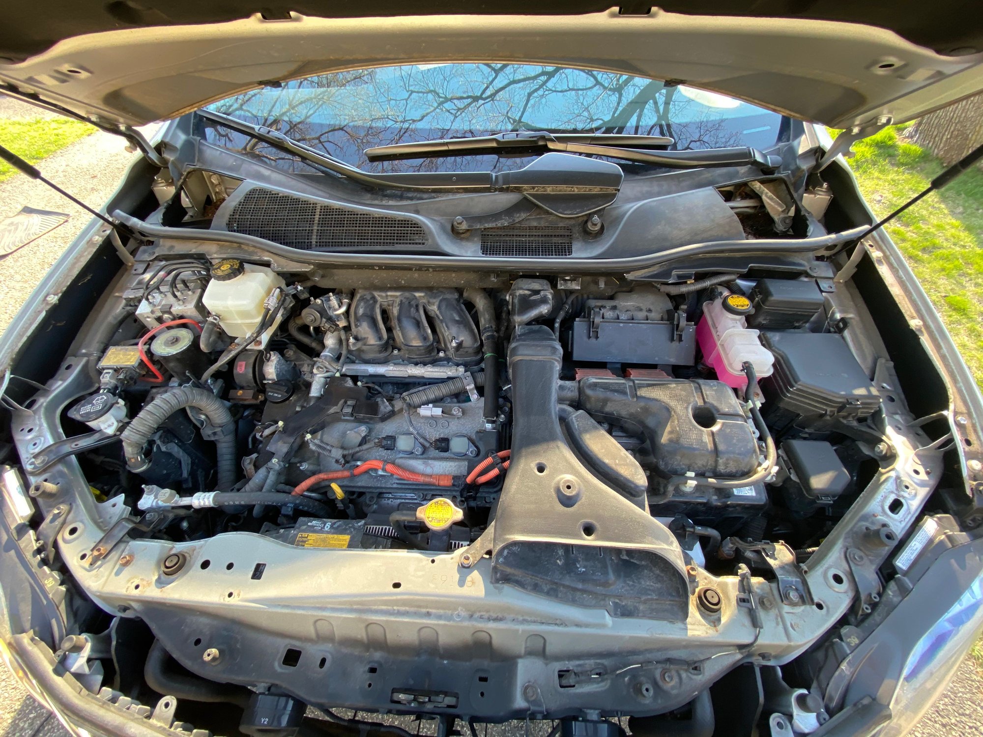

What year is this 450h? Here is some pictures I have from previous repair jobs of a 2010 and I can’t find those connectors. Maybe they engine swapped the wrong type of engine? The 450h came with a 2GR-FXE which uses an Atkinson cycle.

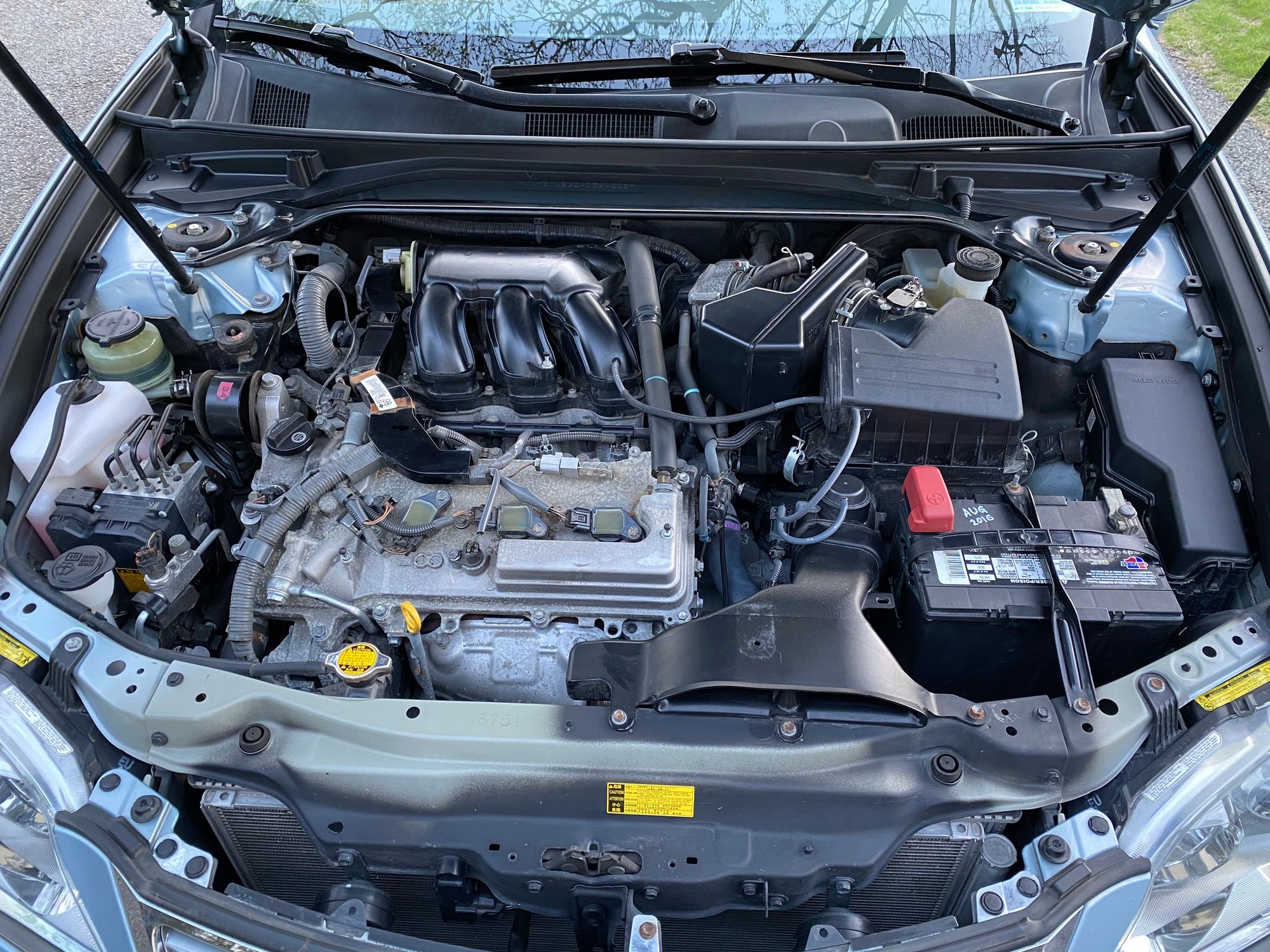

Actually I think that’s what happened. They swapped in a regular 2GR-FE which is used on a non hybrid model. The last photo is a picture of my 2010 ES350 with a 2GR-FE. You can see those exact connectors on it.
2010 Lexus ES350 2GR-FE

my car is 2009.
you might be correct. the wiring on your second last picture is what i have.
this may also explain why one of the wiring case can not be secure to the cam cover...
the cam cover must been swapped, rather than engine as a whole?
