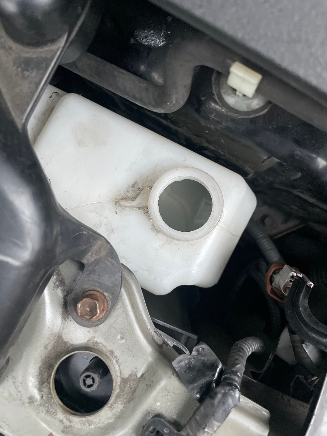

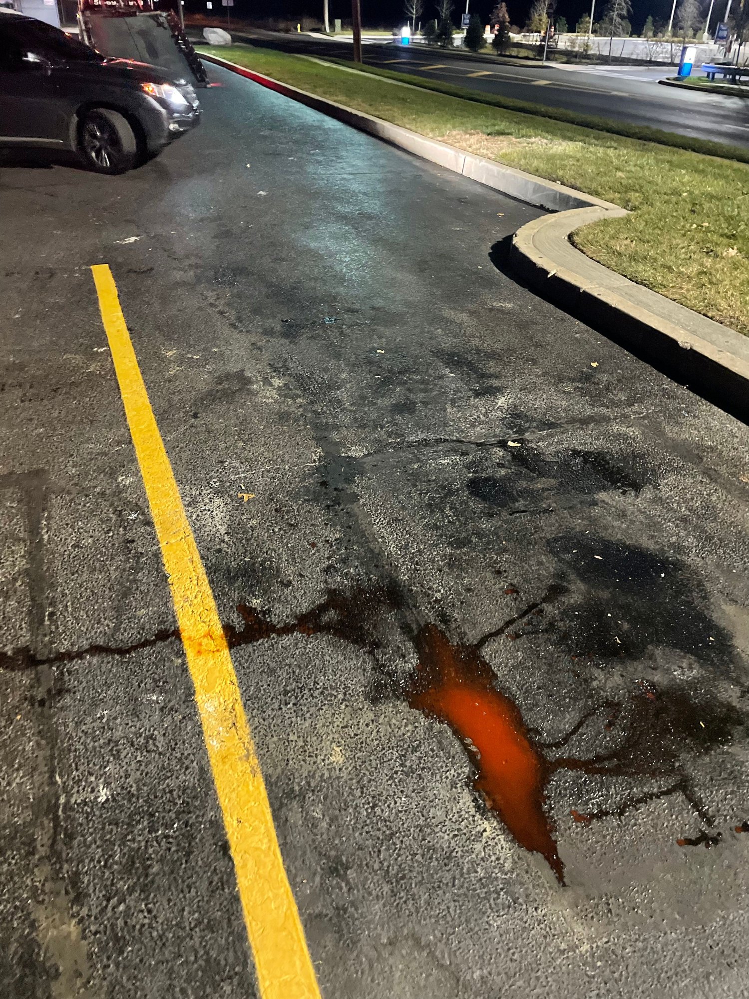

I was Driving my car on a road trip when it suddenly notified me it was overheating. So I pulled over , it didn’t smoke it still starts still drove on and off the tow truck. While we waited on the tow we realized it leaked out all the coolant. Does anyone know why this could have happened and what things I should check first. I poured water in the radiator (black circle) and it did start to leak but then someone told me that was the wrong place to pour water. But when I looked It up it is attached to the fan and the coolant reservoir so I feel like it was the right place but not sure now and kinda nervous. But please anyone who knows about these cars help me out. It’s an excellent driving car 161,410 miles no accidents no issues ever I’ve only had it for 5 months.

Radiator is probably blown very common on this model. The coolant reservoir is attached to the cooling fan shroud as in your picture you didn't do anything wrong except shouldn't really be using tap or bottled water.
edit - forgot to say be sure to get a Denso radiator they fix exactly like OEM. Also it could be a water pump failure.
