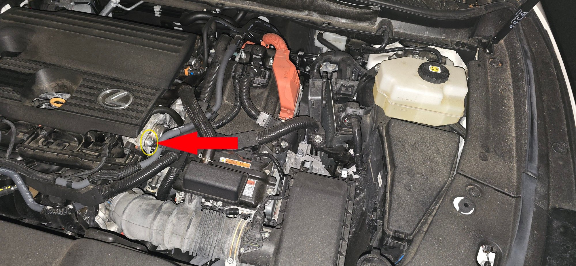

Hi Folks,
Looking to get some guidance on Jump Starting my 2023 RX350H. I am familiar with the connection points under the hood, and that the negative cable needs to go to the other side of the engine.
My problem as you might suspect, is cables that are too short on my portable jumpers (I have two, and both are too short).
I don't have much car knowledge but reading up enough made it clear that picking a random bolt under the hood near the positive terminal can fry the ECU, which is why I am hoping someone can give me a picture showing which (if any) connection point under the hood on the driver side is safe for use as the negative terminal.
I don't want to crawl through the car again to open the trunk, to get direct access to the battery or drop another 100 bucks on another jumper with longer cables.
I have the Gooloo jumpers btw and they have a proprietary connector so I can't even get longer cables without modifying the cables which I have neither the tools or skills to do.
Any help would be greatly appreciated, thanks.

I updated my post to include an image of under the hood (not my car, got it off the internet but exact match) and not much places to connect and a video of a person who is showing some Lexus docs saying explicitly which points not to use. Doesn't leave much room for other options.
As far as I see most other stuff is painted black. I was at the dealership today (got the battery replaced under warranty) and one person there said the painted latch could work......

Hence the pics I posted. That Dealer is showing that you can clamp your negative cable to another unpainted point, in this case it's a bolt on the nearer side of the engine.

Sorry, the pic I sent is the Dealer showing the bolt on the closer side of the engine, near the fuse box with the positive tab, it's probably 30" from the fuse box. How short are your cables??

Quote: Sorry, the pic I sent is the Dealer showing the bolt on the closer side of the engine, near the fuse box with the positive tab, it's probably 30" from the fuse box. How short are your cables??
Sorry, I didn't even realize you had uploaded any image until you pointed it out. I was on VPN, and the image wasn't showing up, not even as a broken icon so I didn't even know the image was there.
And also, THANK YOU so much. I just went to my car and verified, that the cables easily reach between this bolt and the positive terminal. (16 inch cables Gooloo GT4000 btw)
I took a higher res pic to wrap this thread up. For those "who come after"
