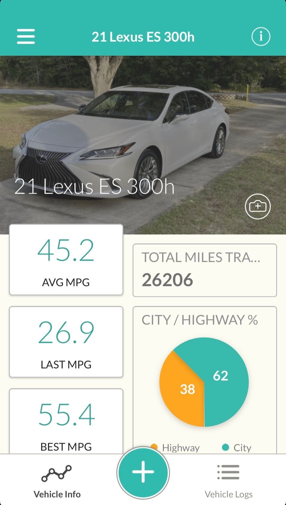

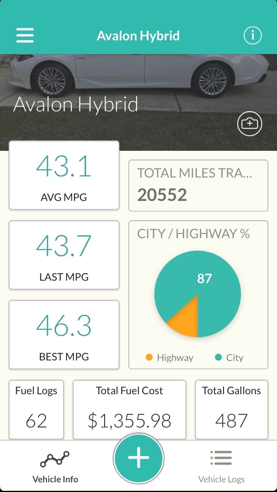

I'm using Ethanol Free and 90-91 octane, whichever I can find on the NX 450H+.
(You can see my mileage in my signature below.)
I started out using Unleaded in my 2020 Avalon Hybrid. I was getting right around 35-38 MPG. My buddy (who talked me into getting a hybrid) said he was using Ethanol Free and it increased around 5 MPG, so I did. After 2-3 tanks of Ethanol Free I started getting 43 MPG average.
I traded the Avalon for the 2021 Lexus ES 300h Ultra Luxury and started from day one with Ethanol Free regular 87 octane gas. Below is the final results the day I sold it (that was why the last was lower as I only topped it off to get to Orlando.
What app is this?

Originally Posted by Valbon8
What app is this?
https://www.fuelly.com
That is the web address. They have a mobile app as well that I use to enter info at the fueling station.
