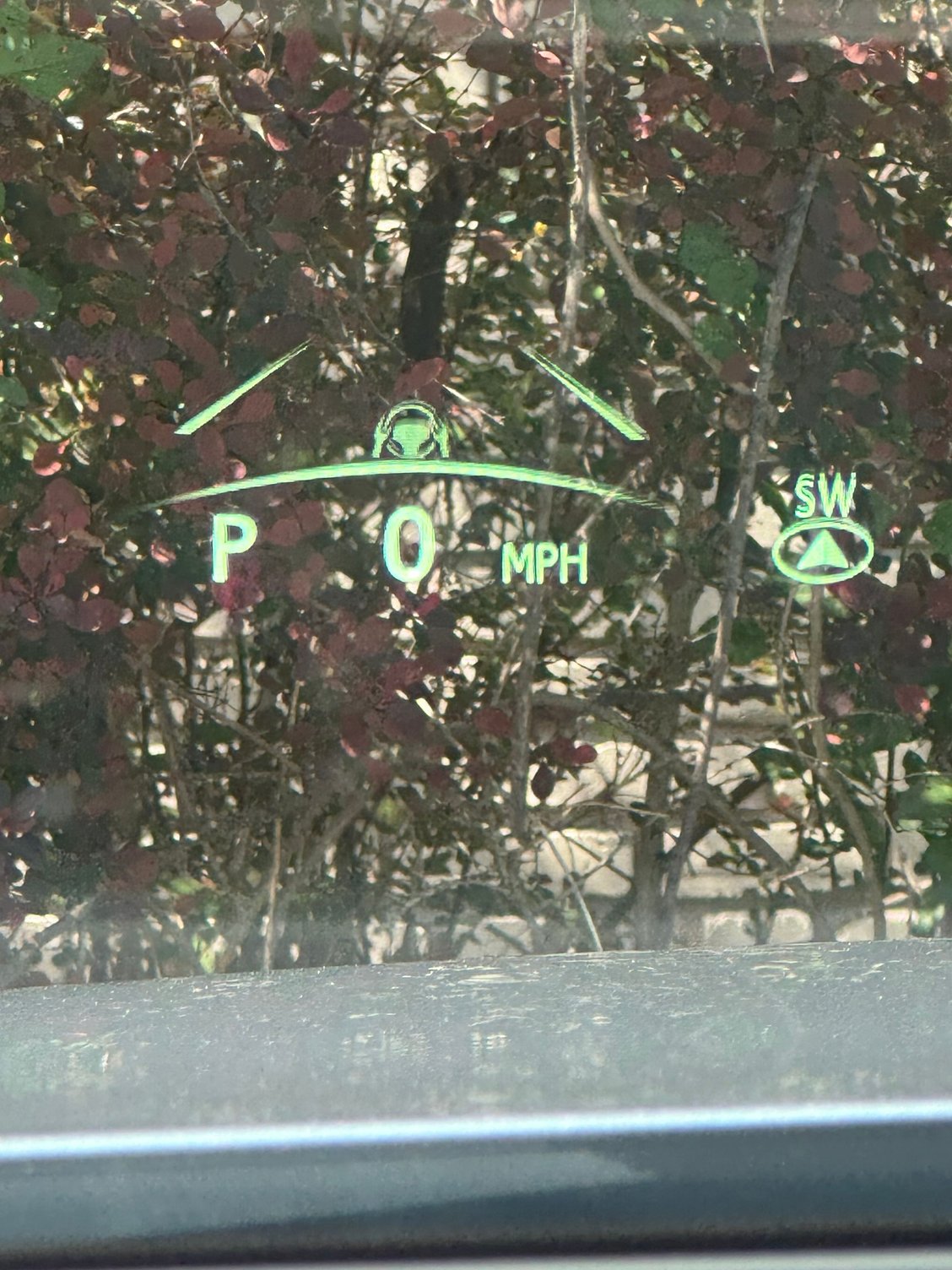

I’ve been playing with this, but, so far, I can’t understand. When you push the down arrow, there are two options, “Adaptive Cruise Mode” and “Cruise Control Mode”. I assume that “Cruise Control Mode” means “Regular Cruise Control”, but it’s not really clear. I can’t seem to make the vehicle drive on cruise with anything but Adaptive Cruise Control. And I’ve never seen any sort of tachometer in the driver’s “speedometer window area” or on the HUD. ??

Thanks for the quick reply. I did what you said. My HUD is in FULL mode (I assume your suggestion to use “FULL STANDARD” mode was a mistake because my choices are FULL STANDARD or MINIMAL). I get this HUD with no tach.

I get exactly the same HUD as in my photo above 🤷🏻‍♂️.
I’ve never seen ANY tachometer in any screen or setting of this vehicle. I’d love for someone to post a photo of that.

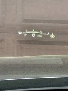

Here you go, this from RX350 F sport. As long as your selecting the regular cruise control, I don't think you seeing it because you have other safety assist things on the display. I have disabled the traffic Jam assist, lane departure, proactive driving assist, cross traffic front, monitoring camera and any steering assist.

So going back to the original poster. Okay so turning off those safety sensors shows rpm on HUD but how does this relates to hybrid malfunction?! maybe Safety sensors failure?!

This was totally helpful but shows that the RPM meter (tach) is almost totally worthless because you have to give up so much to get it. What was Lexus thinking? But thank you, John89, and to prior posters, for helping me figure this out.
