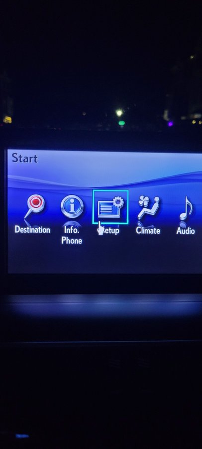

Default Replaced screen and it work perfectly
Originally Posted by slodesign
Please do show that and let us know how you did it.
So I purchased a replacement screen from Ali Express. It was $110. It did take 4 weeks to get delivered. Installation was fairly easy. The hardest part was keeping tabs on where the screws came out off. I took lots of photos before removing them. The video provided was good to show how to remove panels only. There is no need to remove the radio. The display unit is held by just two bolts. It took me about 2 hours to complete. It was well worth the effort. Thank you Doug for your recommendation!!. Below are the before and after photos.
Before replacement
Before replacement
Before replacement
Before replacement
After replacement. As if new.
After replacement.
After replacement.
After replacement.
After replacement.
After replacement.
