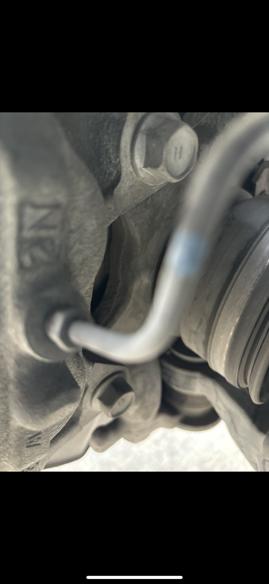

I see two 17mm on top and bottom of caliper that I could remove - but they aren’t the ones mounting the caliper (or should I say caliper bracket?). There are two 19mm iirc that appear to be the caliper bracket bolts needing removal. See pic below. Problem is I can’t get these to budge with breaker bar or my power tools (Milwaukee m12 tools).

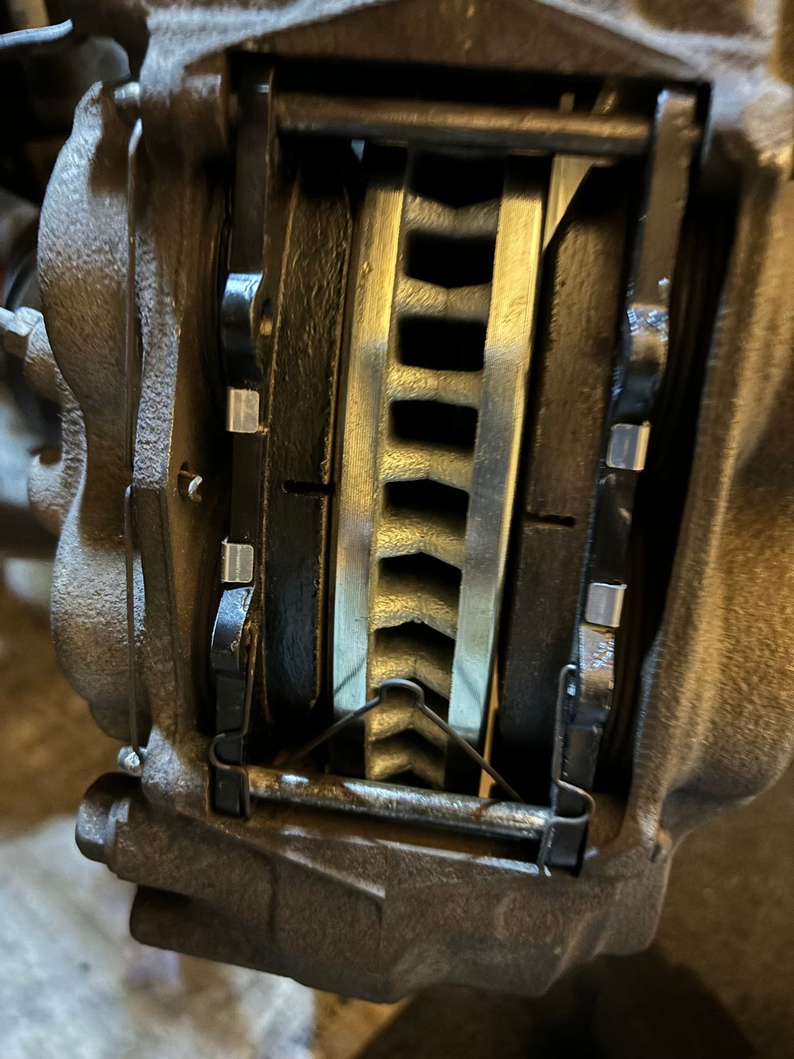

Here are the 17mm bolts below bleeder. (Only top one shown in this pic). Can get these out - but don’t think caliper comes off with these removed.

Your first picture is correct the 19mm bolts are holding the caliper. They are torqued down significantly so they require force to remove. Try turning the steering wheel and you need a long breaker bar

... the two bolts that attach the Caliper to the Steering Knuckle are obvious ... apply PB Blaster the day before attempting removal ... my 2019 GX required a 450 ft-lb air impact gun to remove ... I swear Toyota used red locktite on these things ... have never before experienced this with more 4-Runners than I can count ... sometimes alternating between the tightening direction and loosening direction will break the threads free ...

I think you're right about these bolts. The torque spec is 136ftlbs. While they are resuable, I have new ones and they have a very light pink coating on the threads, could be some for of loctite. I long breaker bar worked well for me.

Do not mess with these ... they hold the two caliper halves together ...

oops…too late. I took one or two out when caliper was still mounted. Put them right back on after confirming it didn’t release the caliper.
What issue might I expect? Torque spec for those 17mm? I’ll double check.

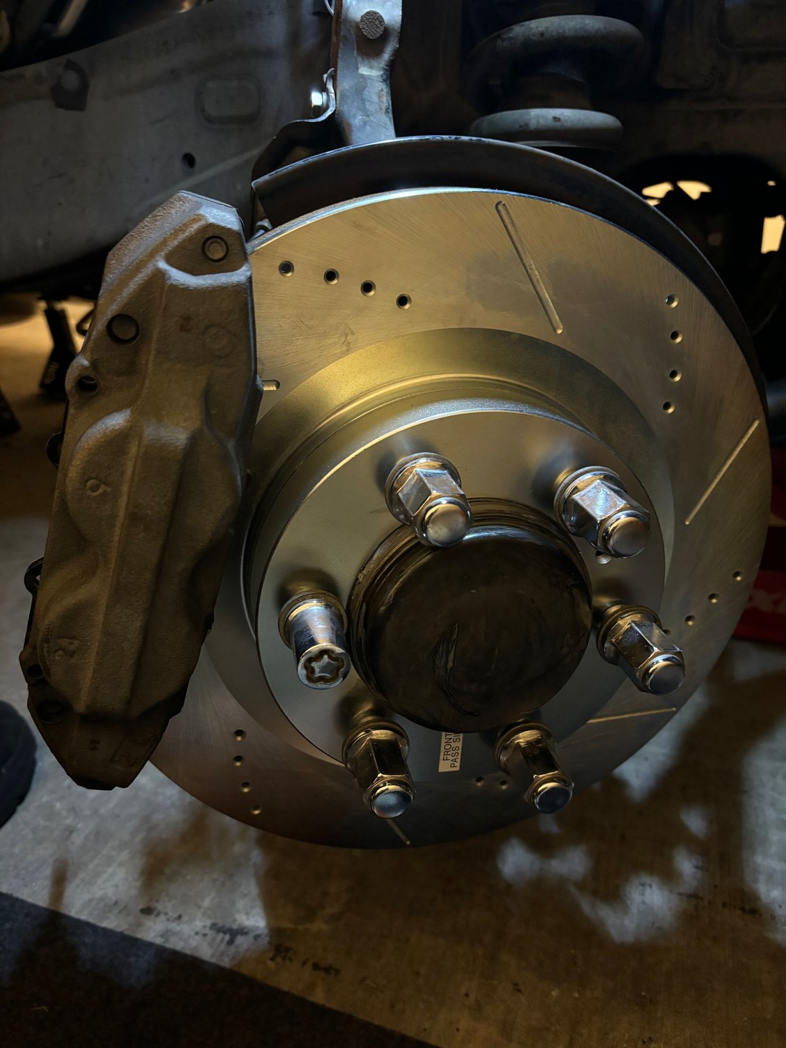

I have to say the power stop kit is pretty good on the test drive and bedding in process.
Attempting rears now.
