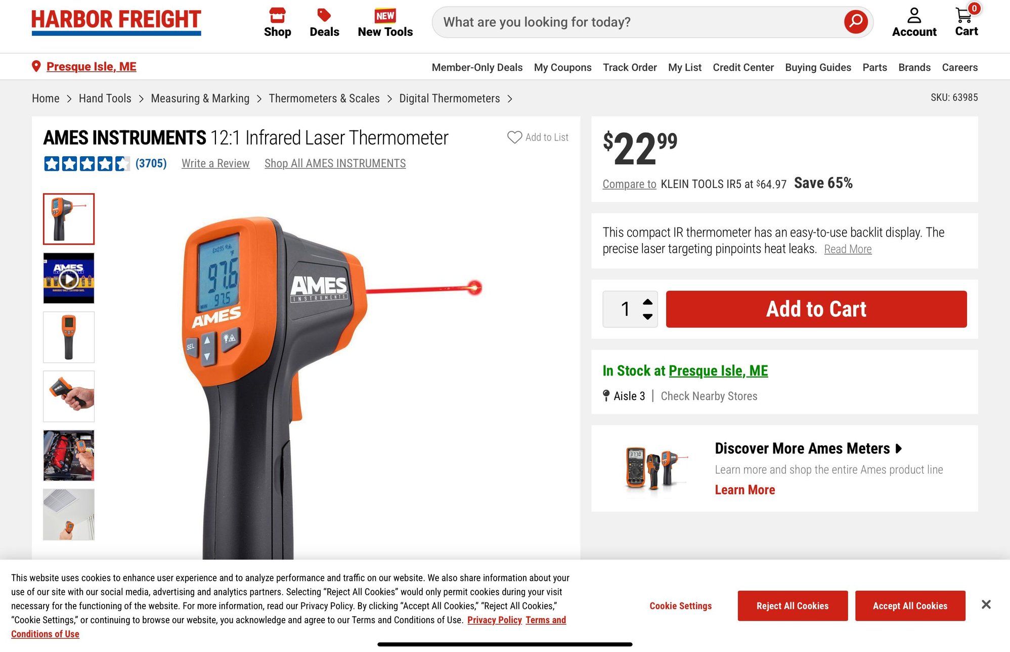

A simple and cheap way to see if any calipers are starting to drag and cheap. No need for scientific accuracy of a few degrees. If one is significantly different than others that is something to look into.
https://www.harborfreight.com/121-in...ter-63985.html

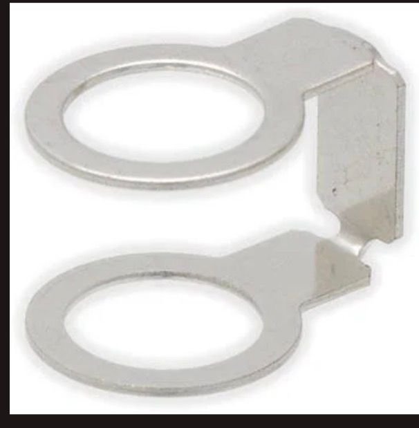

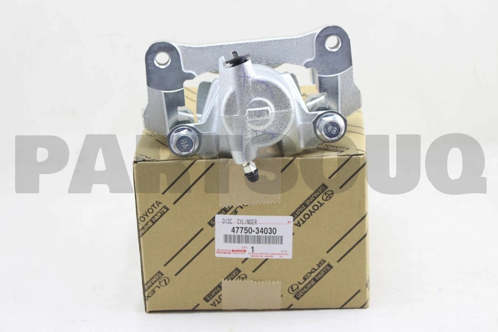

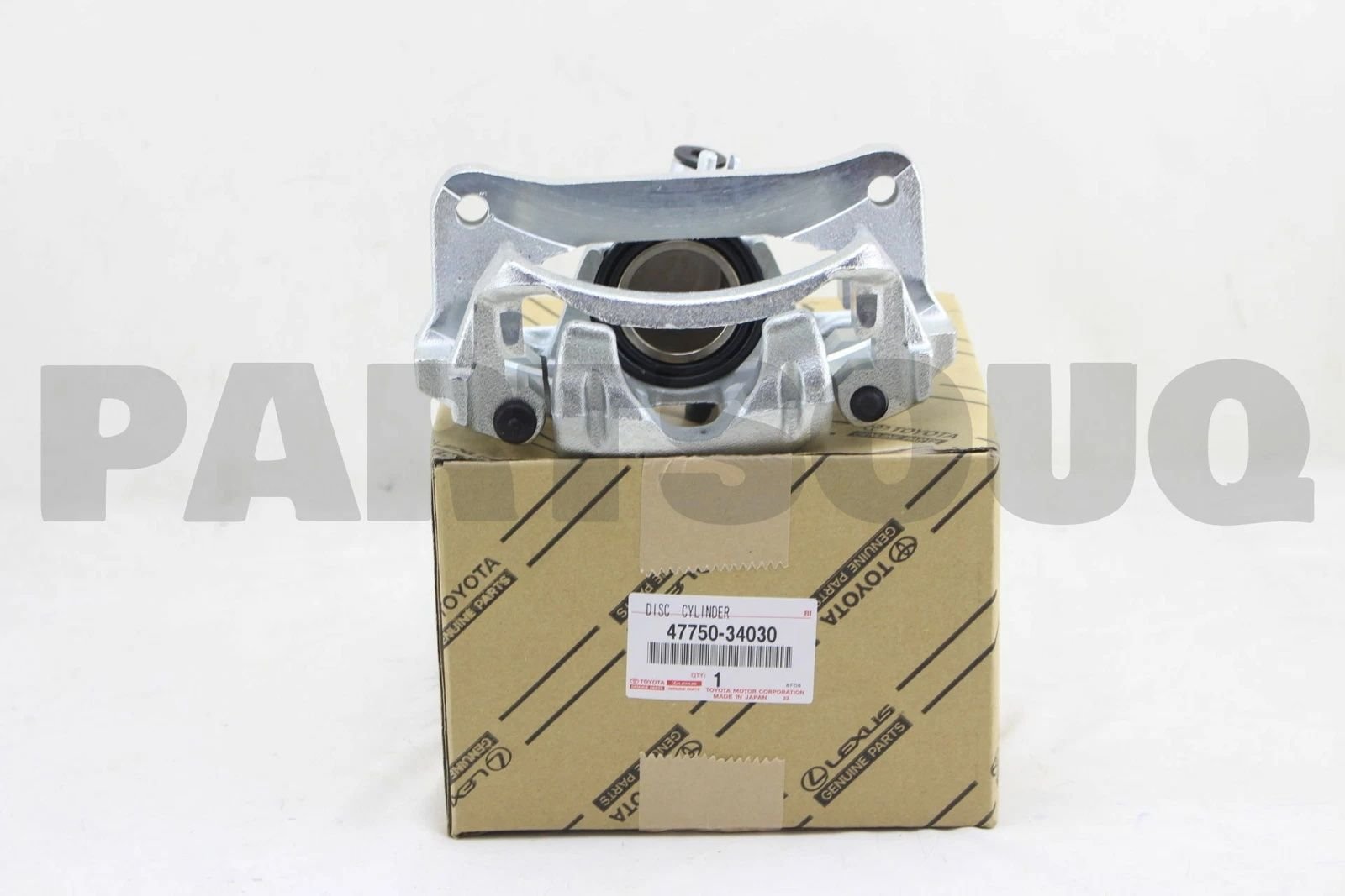

Right rear caliper last year …. Left rear caliper is now calling for replacement.. ordered through Bell Lexus
I forgot to document last time but that washer for banjo fitting on caliper is this
PN: 4738950020
