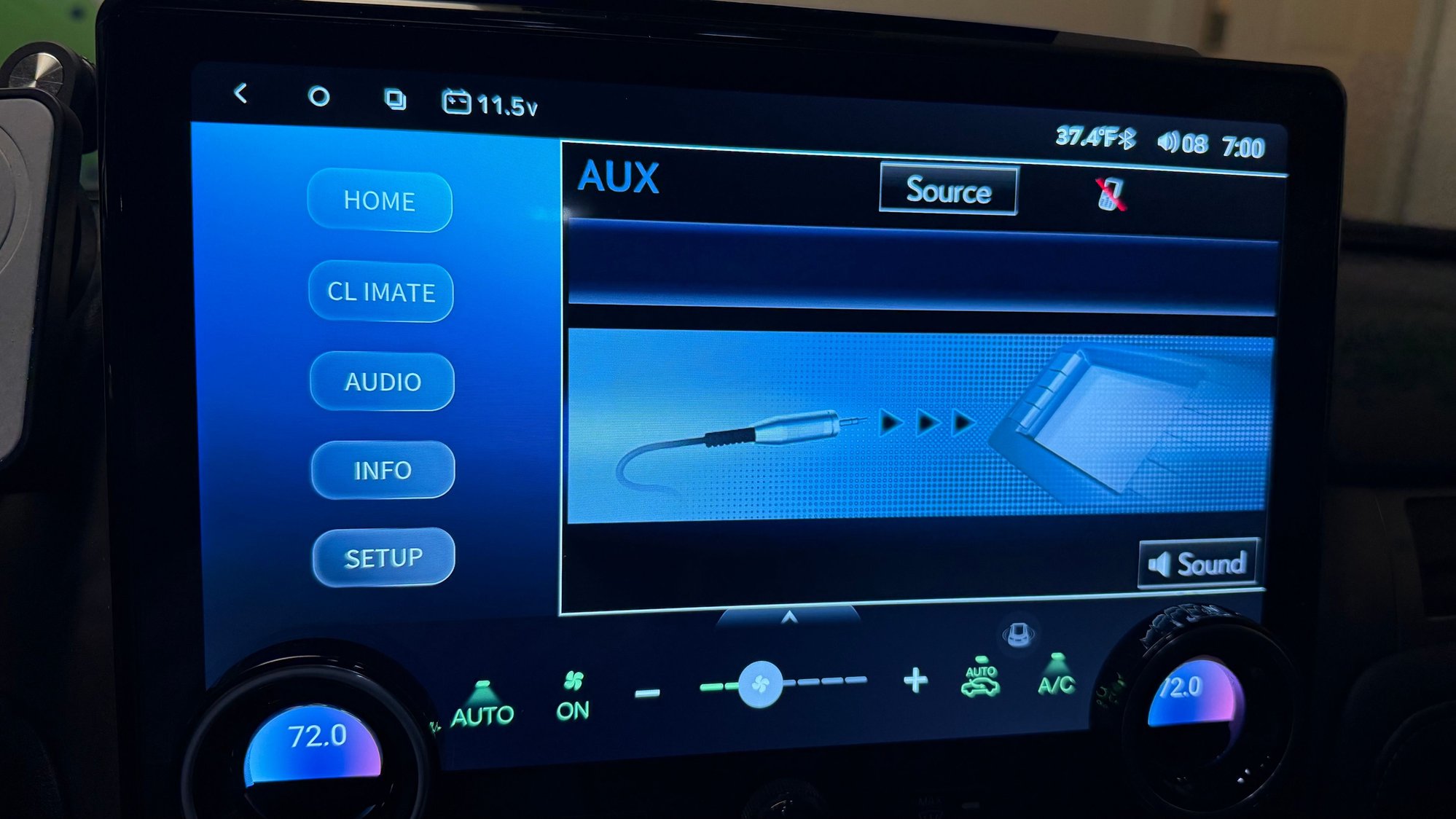

Just so some basic information, Lexus/Toyota head unit is not just a simple Audio head unit, it is customized with built-in ECU and CAN communication unit, without it, you will lose not only just audio, HVAC, functions, but all kinds of communication, such as airbag status, steering control, and other critical communications between various ECUs. Therefore, no matter which path that you would like to take to replace or modify the existing setup, you will need a basically functional OEM head unit. So, in your case, the best case would be a bad or burned out LCD screen, then you have the option to go with after market Android unit that works injunction with the OEM head unit with some added benefits. The worst scenario, you have a malfunction head unit, then you will have it either replaced or repaired as the first and only step before any other options that you may like. Unfortunately there is just not any other way around it.
As for Android unit option, there are few to choose from: (after you have a fully functional OEM head unit)
1) add-on unit that utilize the existing screen. (That option may not apply to you if your LCD screen is bad or burned out)
2) similar looks like 2022+ screen layout unit, which will also support Lexus OEM interface and menu, as well as all the OEM audio function, includes HD radio and Satellite Radio, etc.
3) retrofitted GX550 screen layout unit, which will have NO access to OEM interface, such as OEM setup menu, OEM audio, HD radio, Sat radio, dvd player, etc. The unit will have its built-in Android based FM radio only. Other audio sources such as Bluetooth stream will be completely under Android system.
4) a new version of above option but with a major upgrade that WILL support the OEM interface, setup menu, and all OEM audio options. Basically, bring the best of both OEM and Android functionalities. I am currently doing testing of the unit for manufacturer, and new unit should be released in April if not sooner. My personal first impression is very positive. Here is the integrated OEM interface for reference:
will keep everyone posted with the final review and results in coming days.
