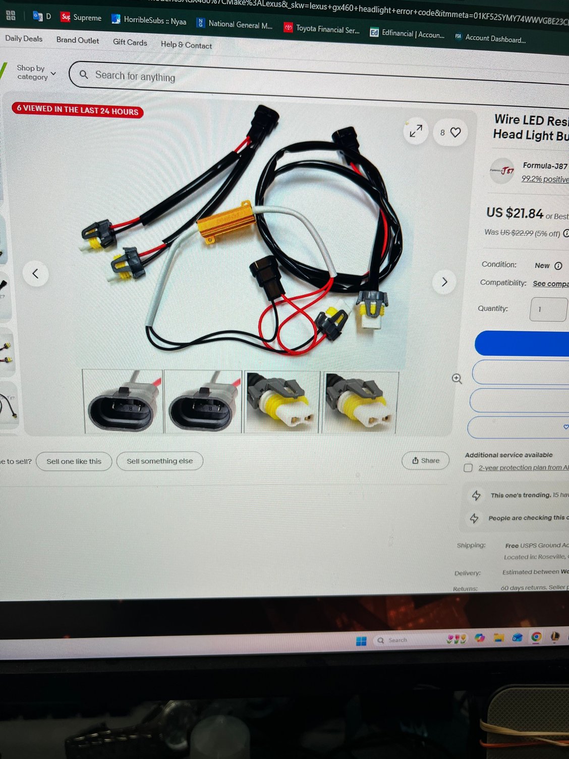

Hello everyone I’m new just got a 2015 gx460 I had to replace the passenger head light. I went aftermarket because it’s whithin my budget. I’m getting the headlight system error. How would I go in fixing this. This is the eBay light I got. Would this wire harness fix the problem? Please and thank you. I’ve watch gxbob video but my wire that came with the headlamp are different.

Hello, sorry to hear you are having this issue, that harness plugs looks like HID ballast plugs for the 2010-2013 headlughts not the 2015-2019, double check that. As for the error, It's better if you can scan the code and check exactly what is going on with the headlight system and what is triggering it. For my exprience, aftermarket headlights dont come with the decoder that signals the headlight ECU that there is an actual headlight there, but before going further, scan and post here the code you are getting
