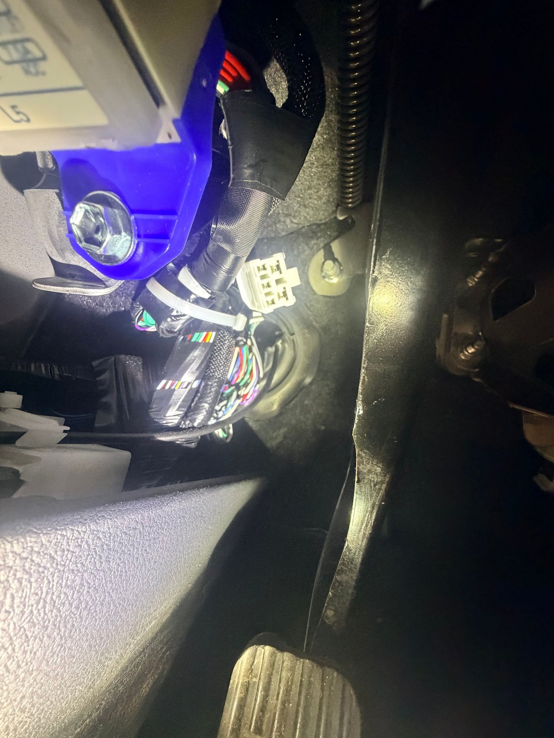

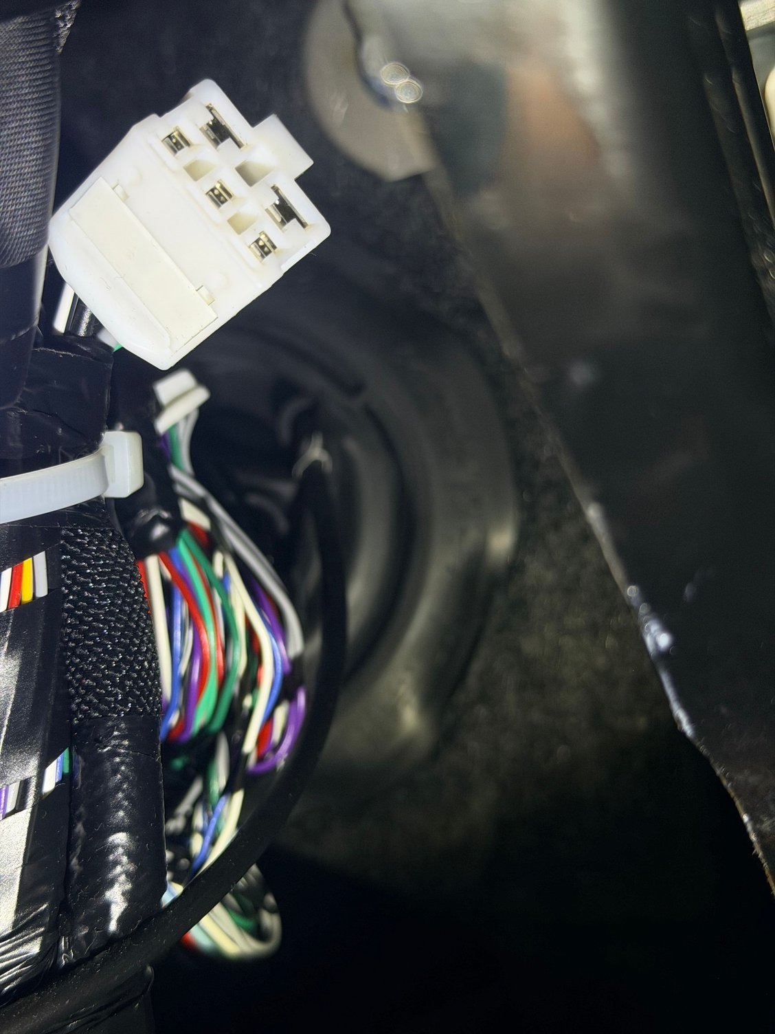

I have a 2023 premium GX460. I was searching for a 12V access point under the driver’s footwell in the fuse box and found an empty socket. It’s not connected to anything, and when I tested the voltage across its terminals, I discovered that it maintains a constant 12V. Could you please identify the purpose of this socket? I suspect it’s intended for a feature in the luxury model. Additionally, I’m curious about the type or model number of the male socket that I can use to connect my accessory to it. I’m also concerned about the safety of using this socket. The location of the socket is as follows: it’s zipped right in front of the fuse box in the driver’s footwell, positioned between the fuse box and the firewall.​​​​​​​
I can't help you on the exact purpose of this plug but I agree it is probably for a feature on the luxury model.
​​​​​​​As far as finding the mating connector, attached is the Toyota connector bible. In there is part numbers for housing and pins and how to repair and assemble connectors.

Interesting. My 2022 has it as well.
Odd they'd have an "exposed" 12v connector like that.
EDIT, I am going with provision for trailer brake controller.
They sell these plug and play kits and that harness sure looks close to perfect
https://www.trailerjacks.com/2010-20...konsha-8508220
Yep yep

Yes, it’s weird that a 12v connector is left open like that. I find the harness in the link helpful. I am just hopeful to find only the male socket, which would be of a fraction of the cost of this harness.

I found the harness on Amazon. I will order and try if it works and let you know. Thanks again!

I can confirm that this harness works and provide a constant 12v.
I also found the OEM harness that comes with the GX which is obviously compatible.
