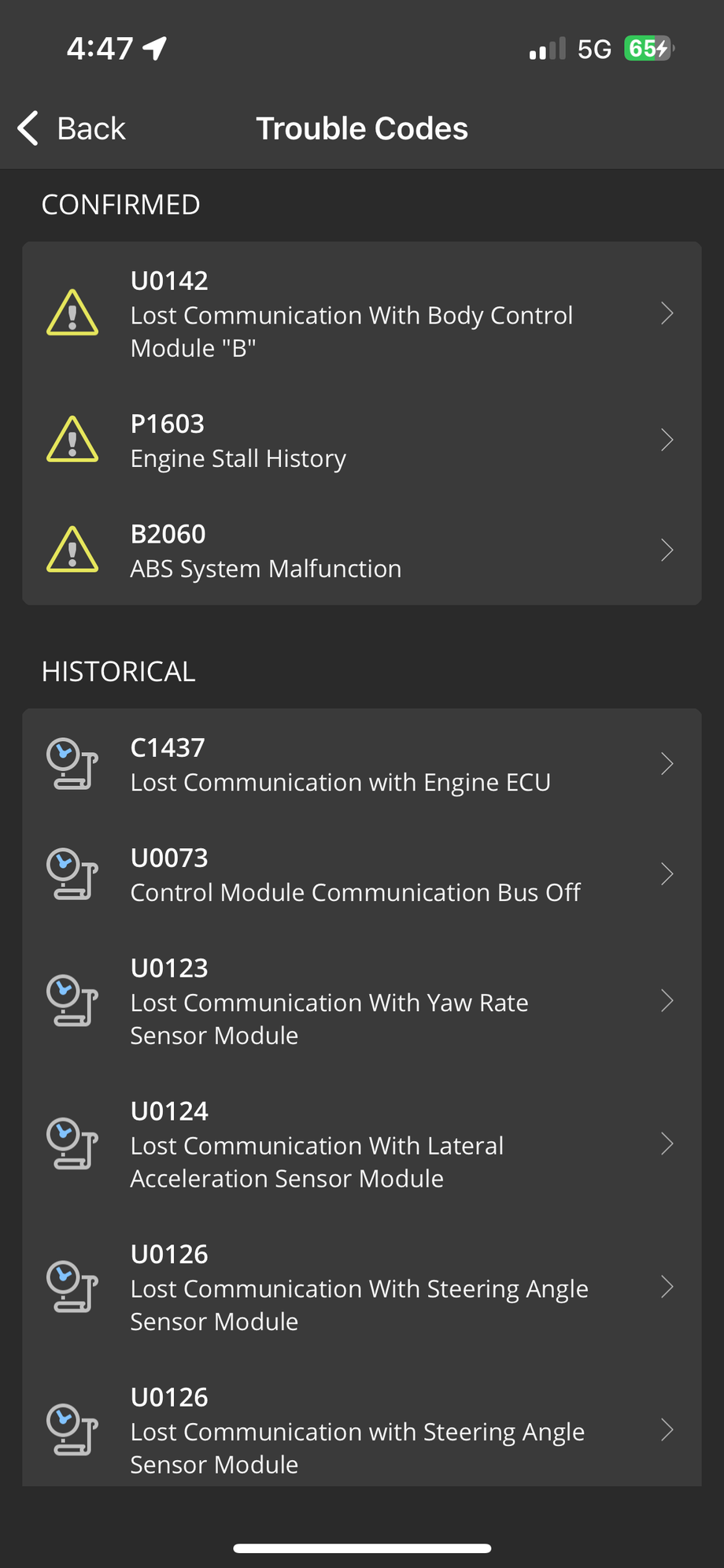

I was able to pull codes from OBDLink with a package specifically for lexus:
Does this mean anything to all of you - the main thing is this is triggered by hot days.
Seemingly no codes showing issues with climate system, correct?
This makes me weary of paying $500 for an AC system diagnostic if this can be ruled out just from scans.
Could it be the battery?

You have introduced so many variables its difficult to just say this is the issue over the internet.
First thing is unplug the addon carplay unit, get back to as stock as possible. Test the vehicle to see if the xmas lights go away, or clear and test in the exact same temperatures.
Second thing is test your battery after a full charge (remove surface charge before testing fyi). The GX does not like when the battery is low or near bad. A weak battery will sometimes cause comm failure codes.
From the looks of it a select circuit is unhappy at specific ambients, causing a comm fallout. If both of the above steps dont isolate the issue, now we are looking at something that might have not been repaired correctly post collision or something else that coincidentally has failed presently. At that point i'd take it to a shop who understands a circuit diagram and can apply reasoning base diagnosis skills. tldr not a parts changer

Based on all these codes (all most all CAN bus related communication errors), I have to say that most likely cause would be your add on CarPlay unit which basically interrupted the head unit to communicate properly with all the ECUs. Definitely remove the unit first before even trying to do anything else.
