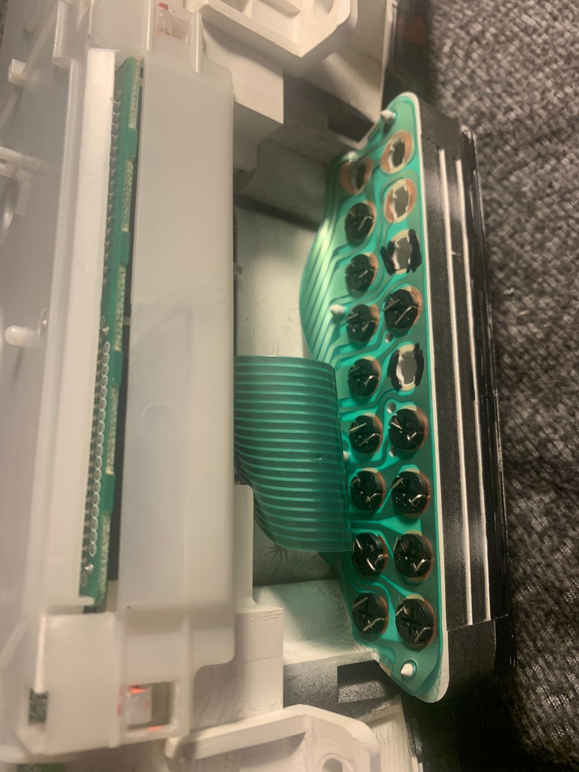

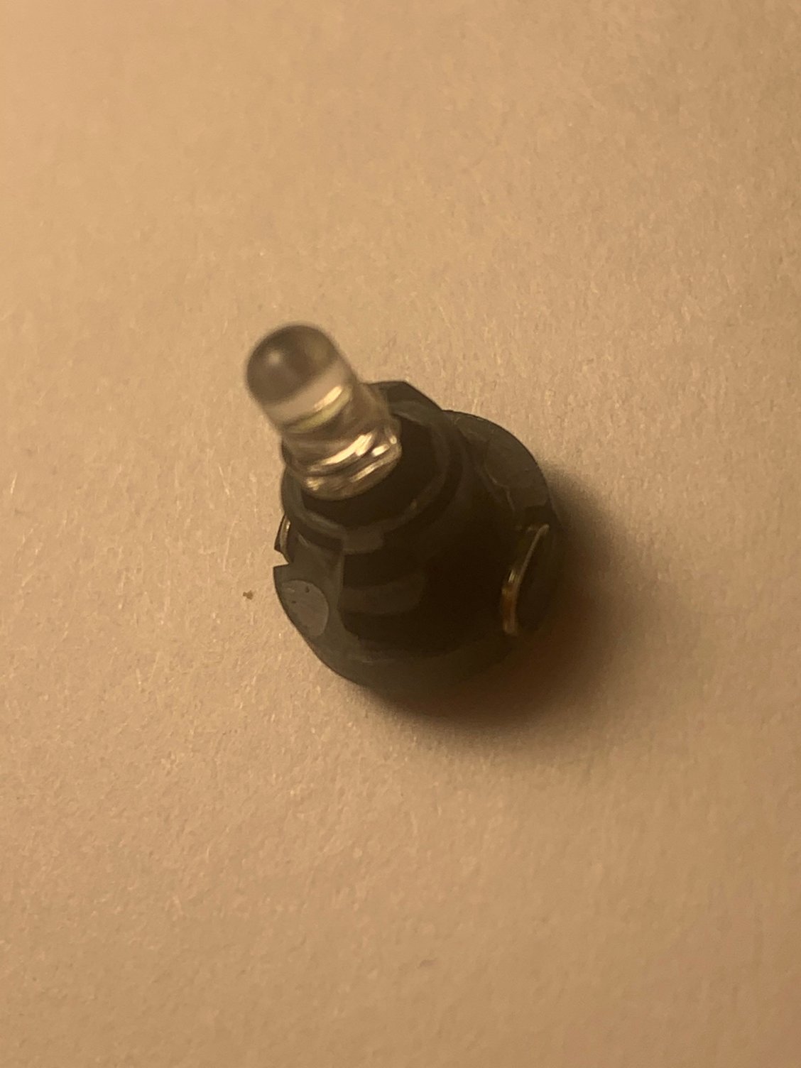

Okay, just did this.
Looks like the VSC off, VSC and ABS light were deliberately removed, probably because 2 weeks after I bought the car the brake master cyl died and the fuel pump died on the first week.
I didn’t know what exact new light to buy so I just switched the rear warning light to the VSC off as thats more useful.
For anyone wanting to do this:
Its a very annoying job to do, some of the screws are very difficult to remove and a lot fell into the abyss
Also to remove the lights, its twist and pull not pinch (some youtube tutorial said pinch)
would have been a 20 minute job, but the fuel guage flipped when I took it off making it a 2 hour job as I had to open it completely and flip it over.
