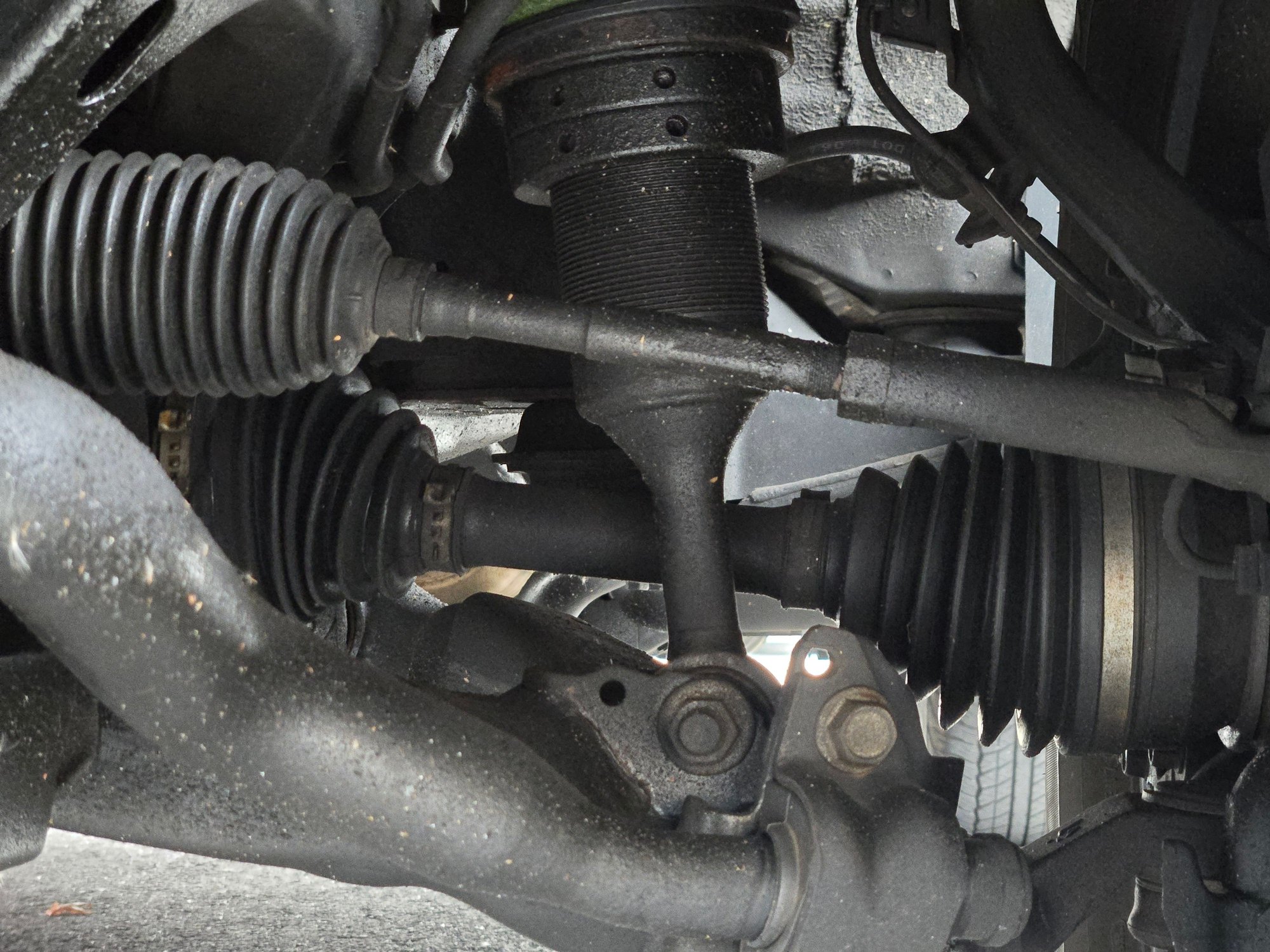

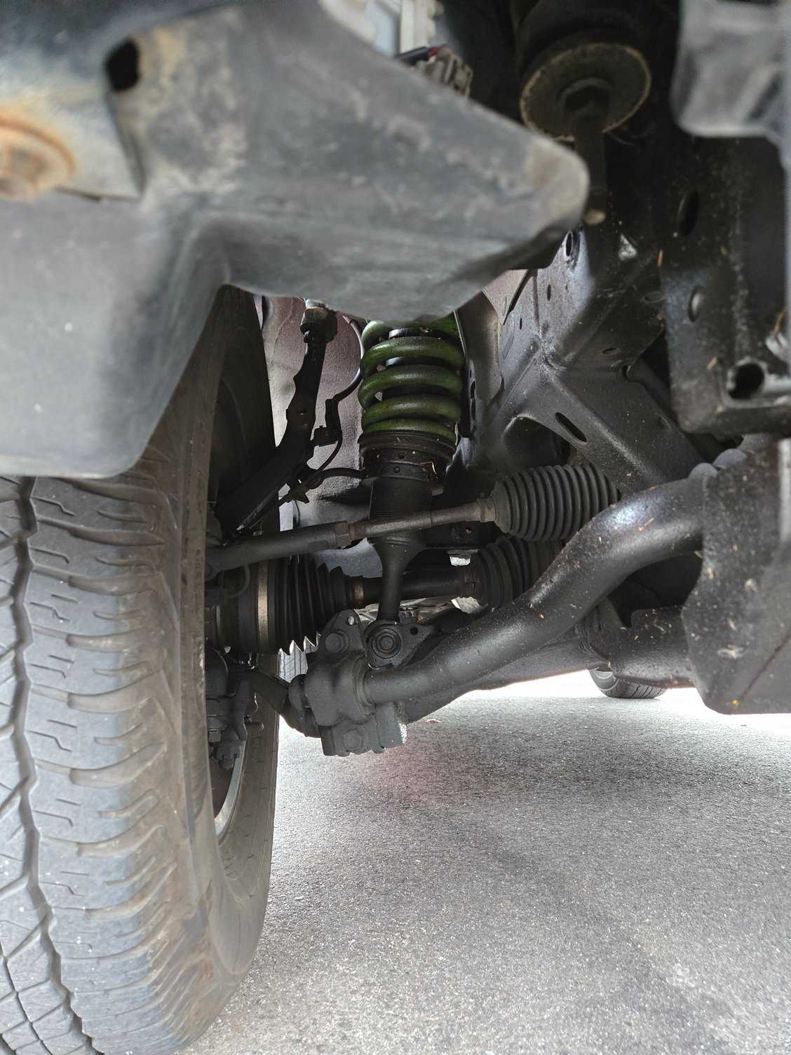

I realized I was mistaken. Upon checking again today, I noticed the high angle on the inner CV joint.
The shiny appearance is due to the application of a rust inhibitor. Before applying it, I didn’t observe any signs of the boot being wet or a broken seal.
Should I replace both (left and right) CV axles? It seems challenging to find the axle assembly for a 2010 model.
  • Lexus Shaft Assembly Front Drive: Would this fit a 2010 model?
  • Toyota CV Axle: According to this link, it fits 2023-2024 4Runners. Can it also work for the GX460? Additionally, should I use the updated axle nut (90177-A0023) with it?
If I proceed, I’d also replace the axle seals:
  • 90311-47013 (Right Oil Seal) – 1 pc
  • 90311-41027 (Left Oil Seal) – 1 pc
The noise becomes more pronounced when turning right, whether it's during a curve or while navigating an on-ramp or off-ramp.
Turning left makes the noise less noticeable, while driving straight brings the noise back, though it's not as loud as when turning right.
I can also feel the vibration through the pedal and floor.
Passenger close up
Driver close up
Passenger far
Driver far

... assume you have springs in the back and not air bags. Your front shocks are adjustable coilovers ... so it is easy to lower the front ... typically a 2:1 relationship ... meaning that adjusting the lower spring perch 1/2" down will result in a 1" reduction in ride height. Based on the rear spring ride height (that is fixed), you may be able to do the above and still maintain the desired rake in terms of stance.
On the axles ... best to go face-to-face with a friendly Lexus parts person who can cross reference Lexus/Toyota part numbers for compatability.
Nothing wrong with running 32's or 33's ... you have aftermarket upper control arms that adjust for camber ... to move the tire forward in the wheel well away from the front body mount for clearance (that may also be chopped for the same reason).
If you are concerned about CV angles, you can also easily do a front differential drop ... inexpensive ... but you will lose some ground clearance ... IMO not enough to be a factor.
