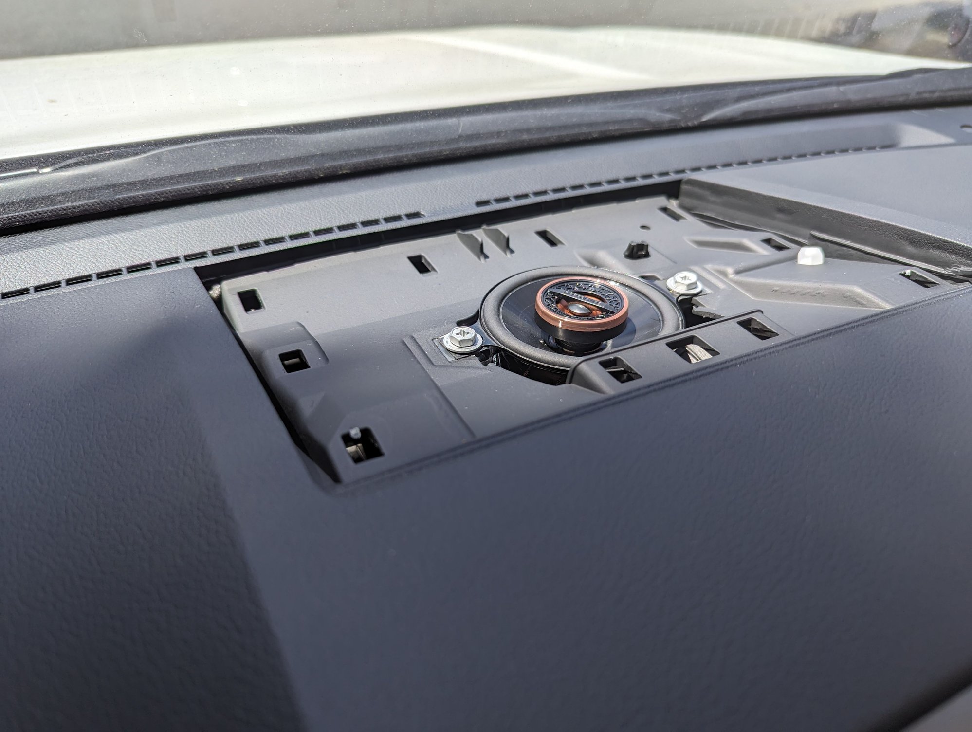

I have a 2023 GX460 with Mark Levinson and thought the sound was lacking and pretty weak to be honest especially the sub so all the threads I have gone over in the forums dealt with replacing speakers for a non mark levinson system. I decided to take on the task and give it a try for the front stage and subwoofer. I keep my system in surround mode and the upgrades I have done put the oem speakers to shame. It plays loud and clean. The amount of bass coming from the doors is pretty remarkable. The oem amp is high quality for all the mids and highs so that didn't need touched for front stage and rear surround. For the dash I used Audiofrog GS40 4" midrange which I had to dremel part of the ring in order to fit it into place as shown in the pic. For the center channel which was a perfect fit was the Infinity Reference REF307F 3 1/2" midrange 2way and for the doors I used Audiofrog GS690 midbass. No problems running the oem ML amp to these speakers with their impedence so anyone with a Mark Levinson sound system wondering if you can change speakers it works fine. The speaker impedence is 4ohm from 6ohm which I replaced and that won't cause any problems.

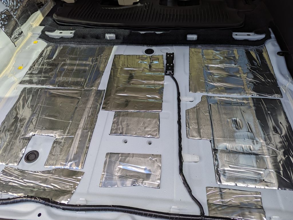

I have replaced the stock 10" sub with a pioneer TS-D10LS2 2 ohm sub powered with an AudioControl 1.300 mono amp. The factory sub box was lined on the flat parts inner and out with sound deadener and filled the box with poly fill. One thing to note I used resonix sound deadener in the entire rear with their 3F sound decoupler as I wanted to prevent any rattling and it worked great. That 10" pounds in the factory box with all the work I have done to it. The pioneer model I went with was a direct fit for the sub box no special drilling of anything needed the sub dropped right in plus screw holes lined right up but I did replace the speaker wire with 12 gauge so I did remove the small factory wiring to and from the sub. Unfortunately I got too distracted and forgot to take pics of the sub installation. I only have this partial pic of the sub area but forgot to take the rest including showing the area covered in sound decoupler. The amount of bass this single 10" puts out is amazing as the body panels are flexing lol.
This was a total pain to do and spent the entire weekend taking everything apart but the end result I couldn't be more happy.
