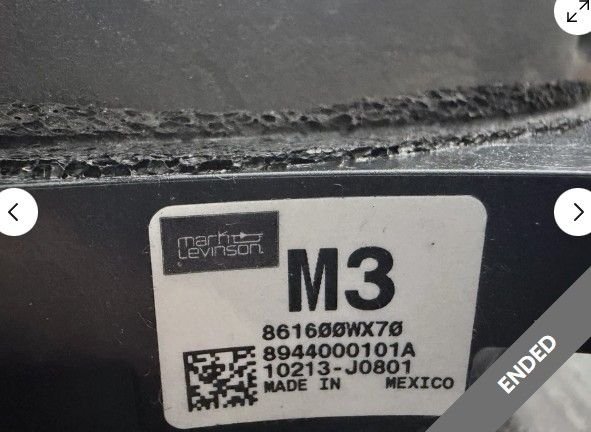

Mr. BullionGX, Would you mind if I picked your brain a bit? I have a 2014 IS350 F Sport with Levinson, and I recently replaced the front door speakers because one was seemingly damaged, and admittedly tried to do it with less expensive speakers, and I am quite disappointed with the sound compared to the OEM, which were the 861600WX70 (8" round). I'm considering the Audiofrog GS8ND2 (although I'm not certain the mounting depth will work). My main question is, do you think these speakers (if they fit in my door) would result in at least as good bass and overall clarity as the OEMs? I don't want to go thru all this again, and spend even more money, and still be disappointed. Or, could you recommend another 8" round that has a good chance to meet or exceed OEM performance? I don't know what ohm the OEM speakers were. It's hard to find that info. I like to crank it up and have the bass hold up nicely. I just did sound deadening in all doors and rear deck. Thanks for your time! This is the OEM...
