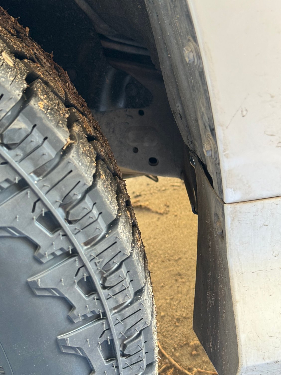

For all those that have made the mod to the infamous lower profile bolt to gain clearance on bigger tires, what is that lower profile bolt's P/N?

Love the look. I'm fixing to put on those same Falkens, and TRD rims as well. Thanks.

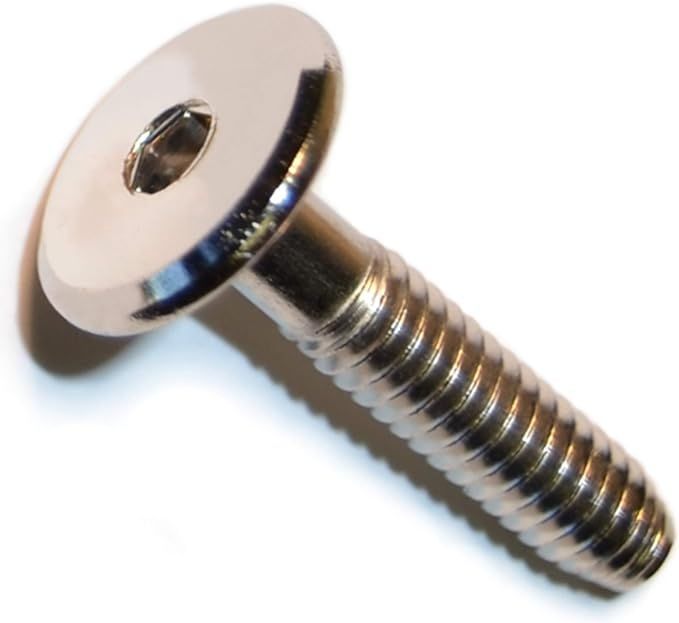

Not sure if these will work but I use bolts with low profile heads, they are called assembly bolts, they are usually 1/4"-20 but you can also get a metric version

You are going to want black oxide I assume otherwise it will stick out like a sore thumb with silver like the picture above. It was a #14 screw that I first used so ~1/4" dia but of course original must be metric, 6 or 7mm.
These should work well if you don't mind going non metric and making your own threads on the way in.
https://www.amazon.com/gp/product/B09TVYTPTD/ref=ppx_yo_dt_b_search_asin_title?ie=UTF8&th=1 https://www.amazon.com/gp/product/B09TVYTPTD/ref=ppx_yo_dt_b_search_asin_title?ie=UTF8&th=1
Then again you would have 50 of the damn things sitting around. If it was me and just filling the hole I would use a 1/4" black nylon shield retainer from the hardware store. I have better luck finding them at hardware stores than automotive stores
https://www.amazon.com/ANTS-PART-Fastener-Chrysler-W705589-S300/dp/B08HS6RTY4/ref=pd_lpo_sccl_1/144-6878690-5068966?pd_rd_w=mw9Wg&content-id=amzn1.sym.1ad2066f-97d2-4731-9356-36b3edf1ae04&pf_rd_p=1ad2066f-97d2-4731-9356-36b3edf1ae04&pf_rd_r=N9A3HQ2TEXAKB0H3Z3C5&pd_rd_wg=5y0nj&pd_rd_r=757355e9-6196-4a61-8376-6ae4e2b8a5bc&pd_rd_i=B08HS6RTY4&th=1 https://www.amazon.com/ANTS-PART-Fastener-Chrysler-W705589-S300/dp/B08HS6RTY4/ref=pd_lpo_sccl_1/144-6878690-5068966?pd_rd_w=mw9Wg&content-id=amzn1.sym.1ad2066f-97d2-4731-9356-36b3edf1ae04&pf_rd_p=1ad2066f-97d2-4731-9356-36b3edf1ae04&pf_rd_r=N9A3HQ2TEXAKB0H3Z3C5&pd_rd_wg=5y0nj&pd_rd_r=757355e9-6196-4a61-8376-6ae4e2b8a5bc&pd_rd_i=B08HS6RTY4&th=1
And then you would have 100 of them for $7 LOL. Hardware stores usually sell them individually or at least small packets. Pretty common so might find those in an auto parts store.

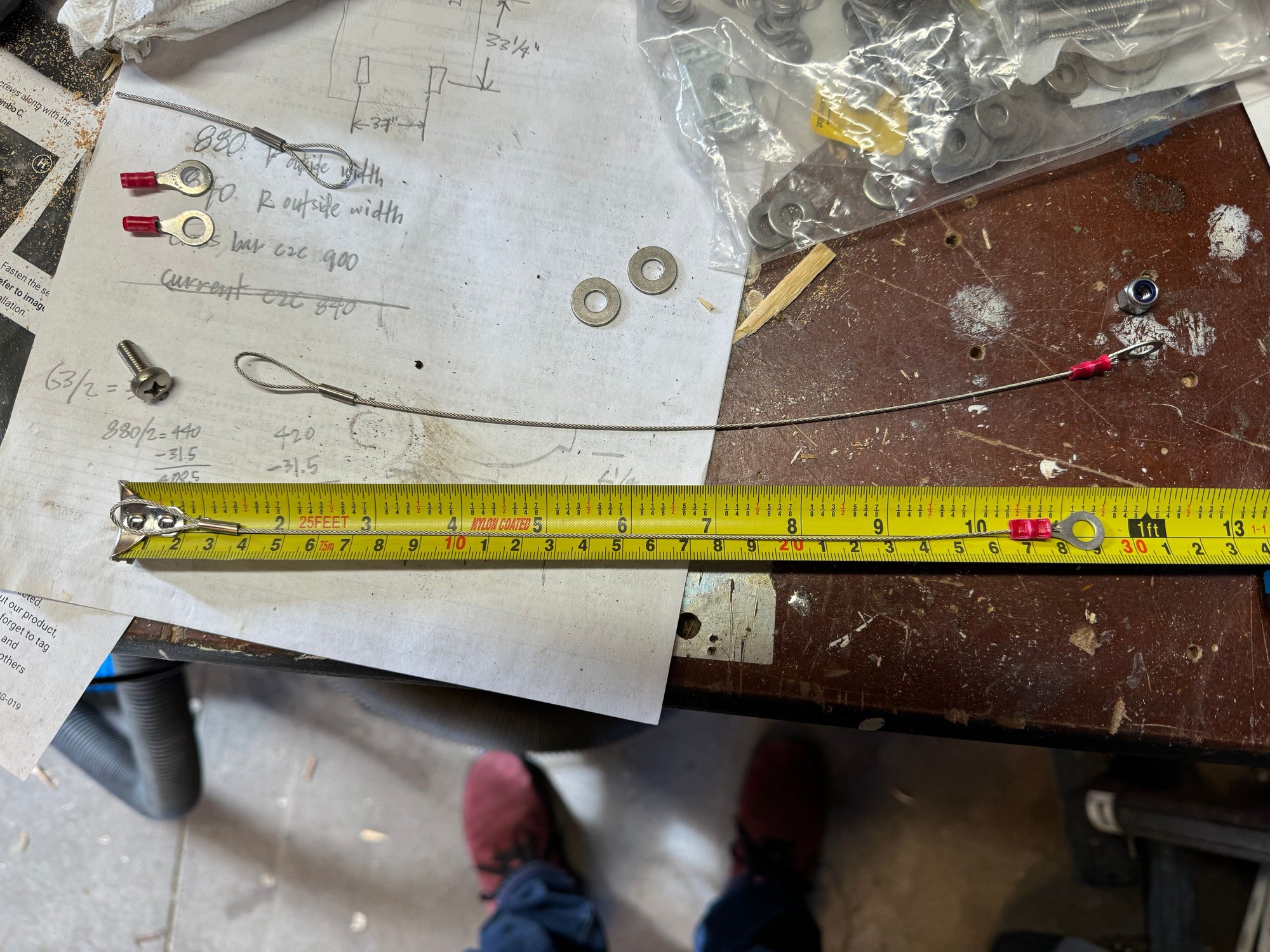

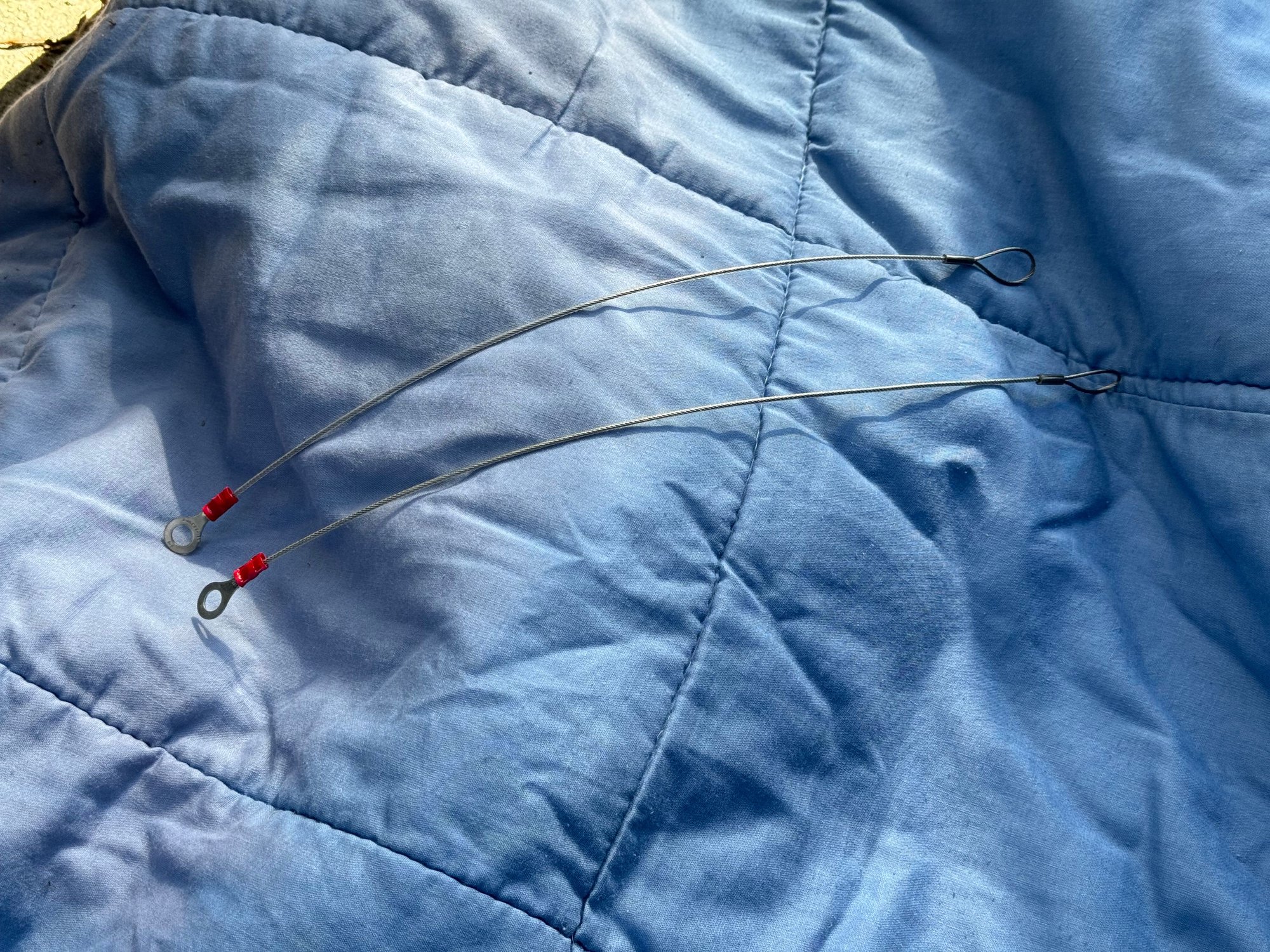

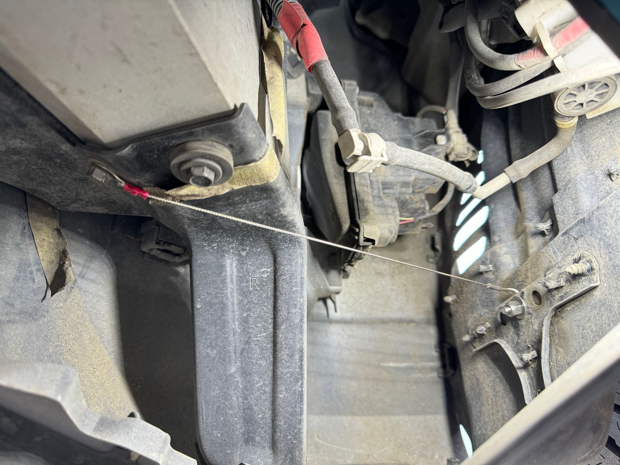

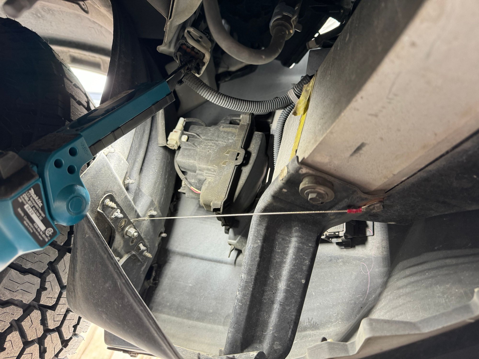

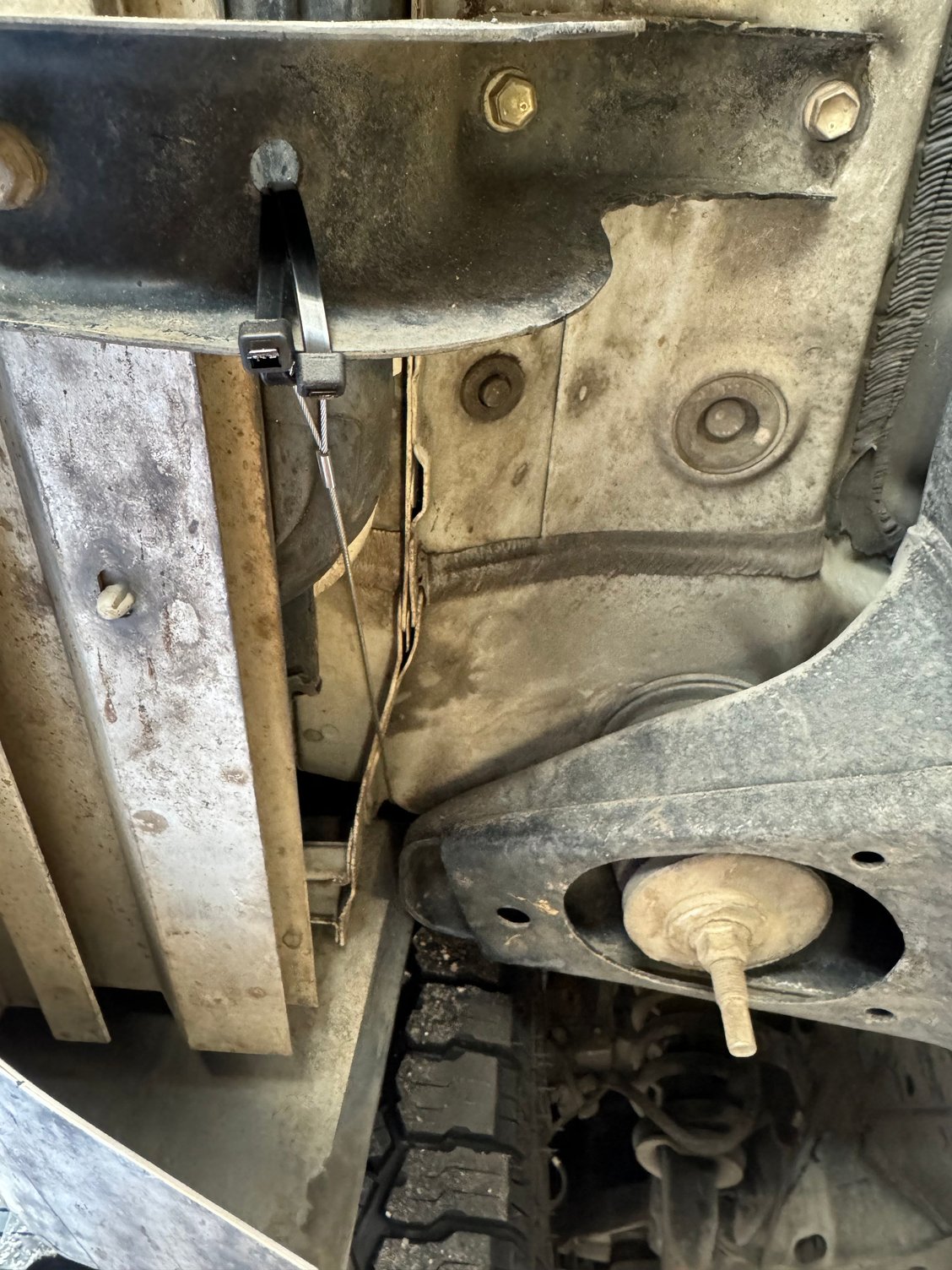

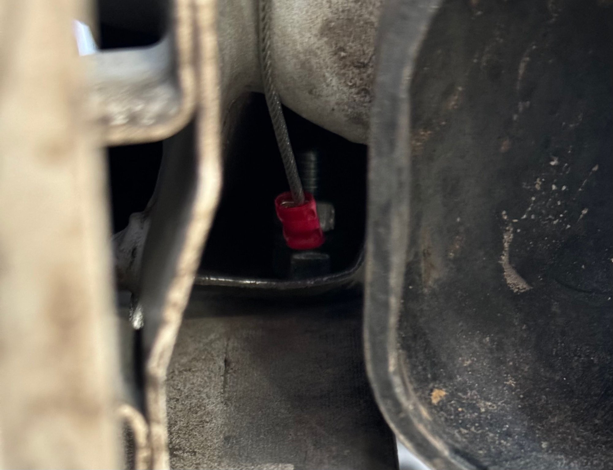

I was also hoping for a non-zip tie solution, which I mostly achieved, but ended up using a couple ties for the final connection to the stock running boards (just to get it done).
  1. I replaced the stock screw and plastic clip with a 1/4-20 truss head screw I had lying around. Secured with a flat washer and nut on backside of fender liner.
  2. Using a nylon coated stainless loop-to-loop lanyard and a 1/4" stud ring terminal, I made a loop-to-eye lanyard about 18" long. These can also be purchased as loop-to-eye from the get go, but then length can't be fine tuned. Might work just fine, though.
    1. 18-8 Stainless Steel Lanyard - 18" Loop-to-Loop, 3/64" Rope Dia., Nylon Coated
    2. 1/4" Stud Ring Terminal, 18-22 ga (I used what I had lying around, but these should work, too.)
  3. Put the ring terminal end of the lanyard over the exposed 1/4-20 truss screw from backside of fender liner and secured with a lock washer and second nut.
  4. Loosely secured the loop end of the lanyard to the stock running board bracket with a zip-tie, and while pushing in the fender liner (hard), tightened the zip-tie. Added a second zip tie for good luck.

I also had rubbing on the front of my fender liners and decided to solve it with another set of coated steel lanyards, this time without any zip-ties.
I like the use of a SS cable, much better than plastic zip ties. And looking at it made me realize that they do make stainless steel zip ties as well.
