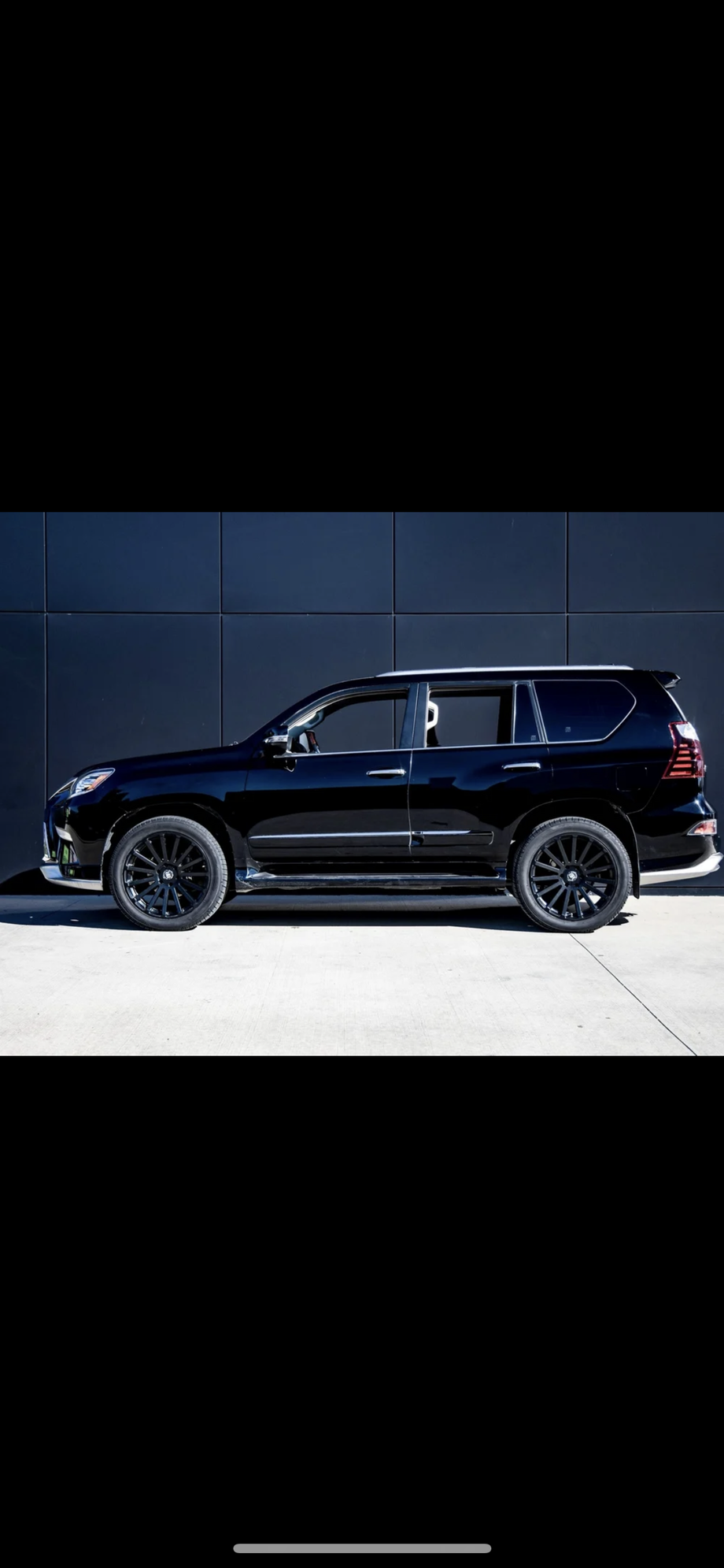

I have 22in low profile tires, bit of vibration compare to original wheels and tires
Hows your alignment? Does the car wander with those numbers you posted or no?

LexusToyo99's Avatar
LexusToyo99
Joined: Nov 2023
Posts: 17
Vibration for my 22in low profile tires when speed is above 70.
