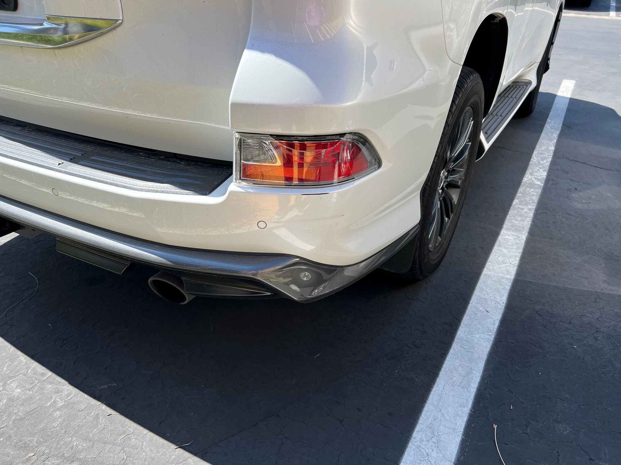

I recently experienced some damage on the passenger side rear bumper on the back-up lens. Can anyone offer advice on how to remove this lens? Does the entire bumper need to be removed?
Broken passenger-side back-up lens on the bumper.

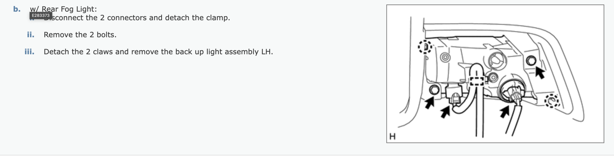

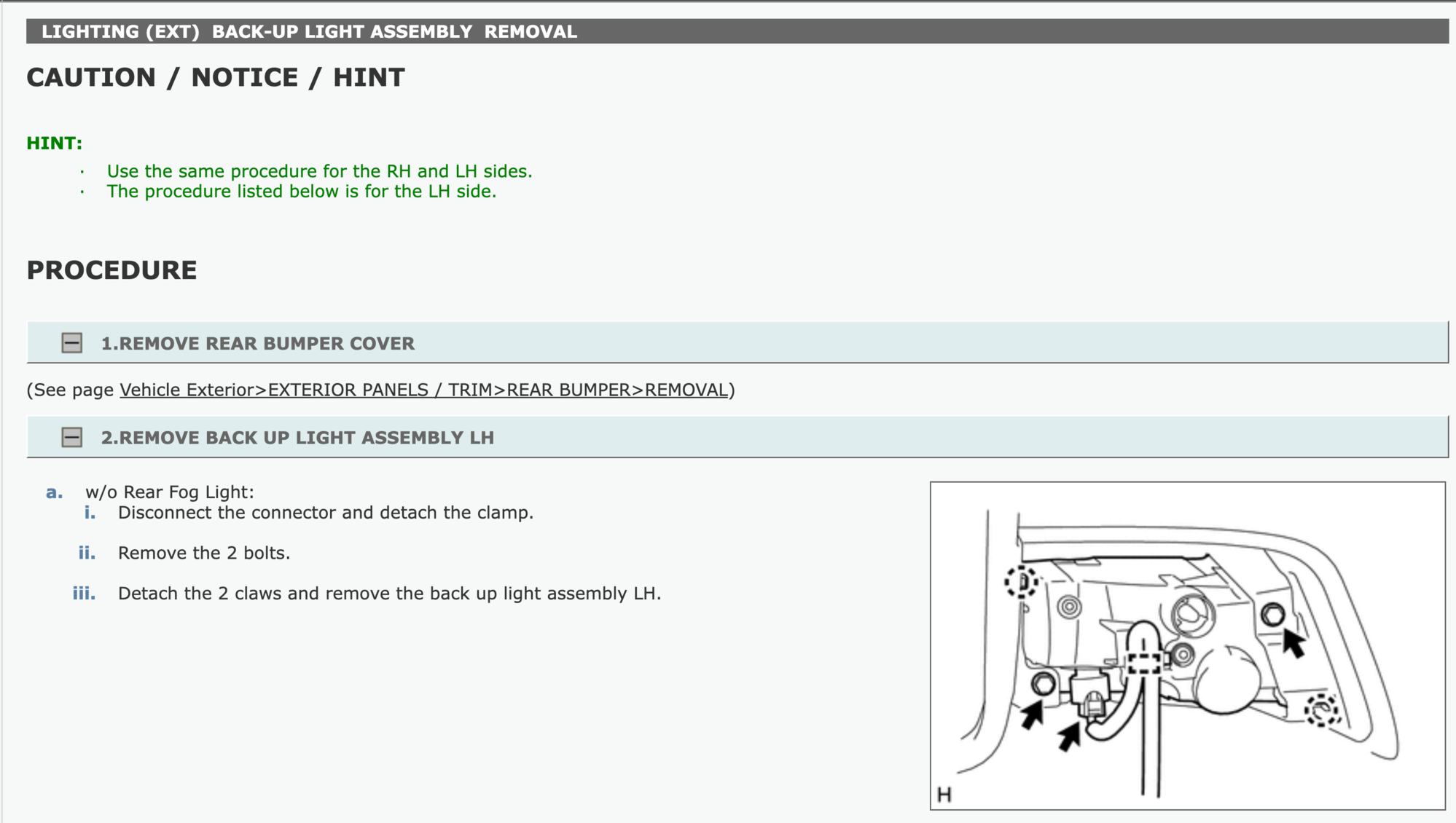

Check out this thread on replacing bulb and may give hints for access
https://www.clublexus.com/forums/gx-...-lights-4.html
FSM seems to always go most invasive but if you can get access to the other side by other means you may be able to get it
Perhaps removing rear floor area as some mods require to access that area for 3rd row?
