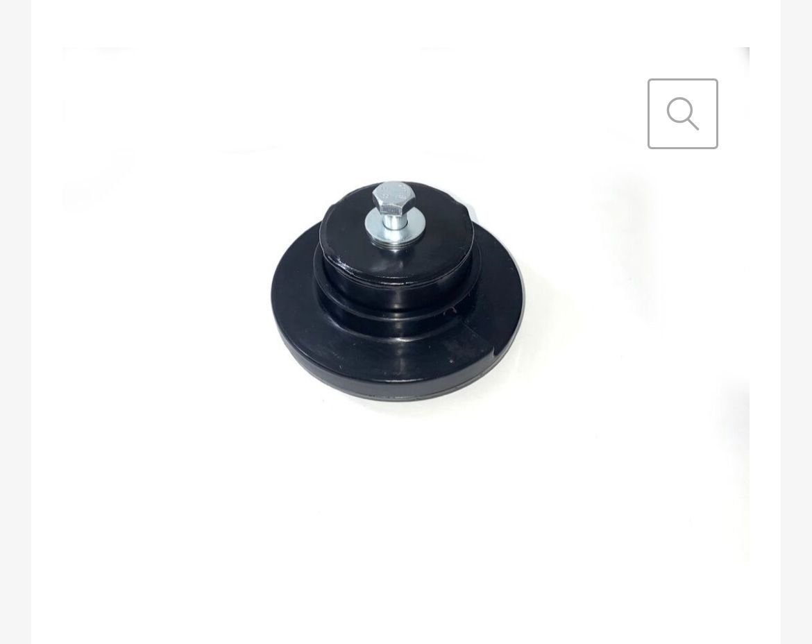

You’d still need something like this though. It needs to be secured to the OEM airbag/spring perch. This is the kit I have.

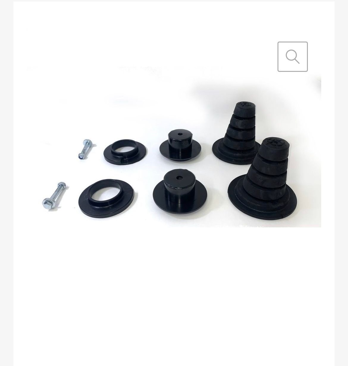

Found this kit very reasonably priced.
https://jdmuscleusa.com/products/ico...IaAsCAEALw_wcB

Those look like they are to be used for a lift, I'm not wanting to increase the height. And the bottom of the Arnott springs are fairly flat, not sure they'd seat into something like what you've linked to. The Arnott springs are similar to the Monroe 90022C kit, which also only have the rubber bushings.
