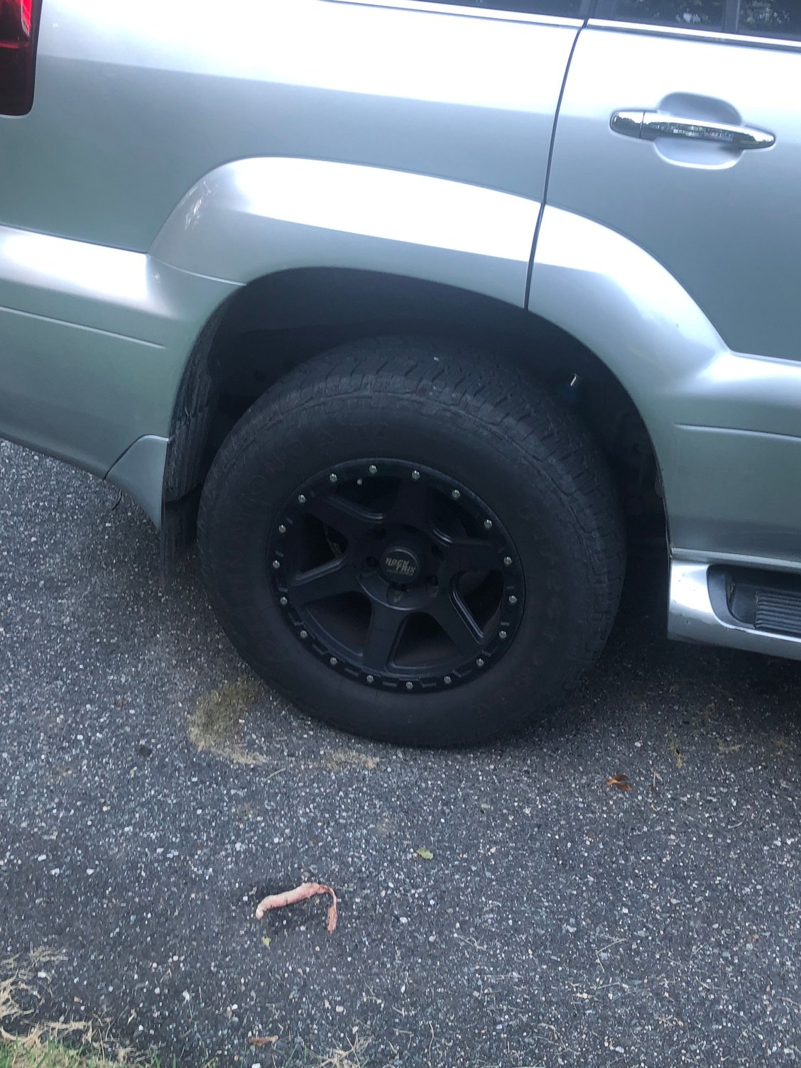

Default All Done
Back up off the bump stops!

Looks good! Pleased with the ride?
Not Disappointed, took it over some harsh speed bumps . So they are stiff enough. My tires have a medium feel to their sidewall. I think the combination will work out well.
