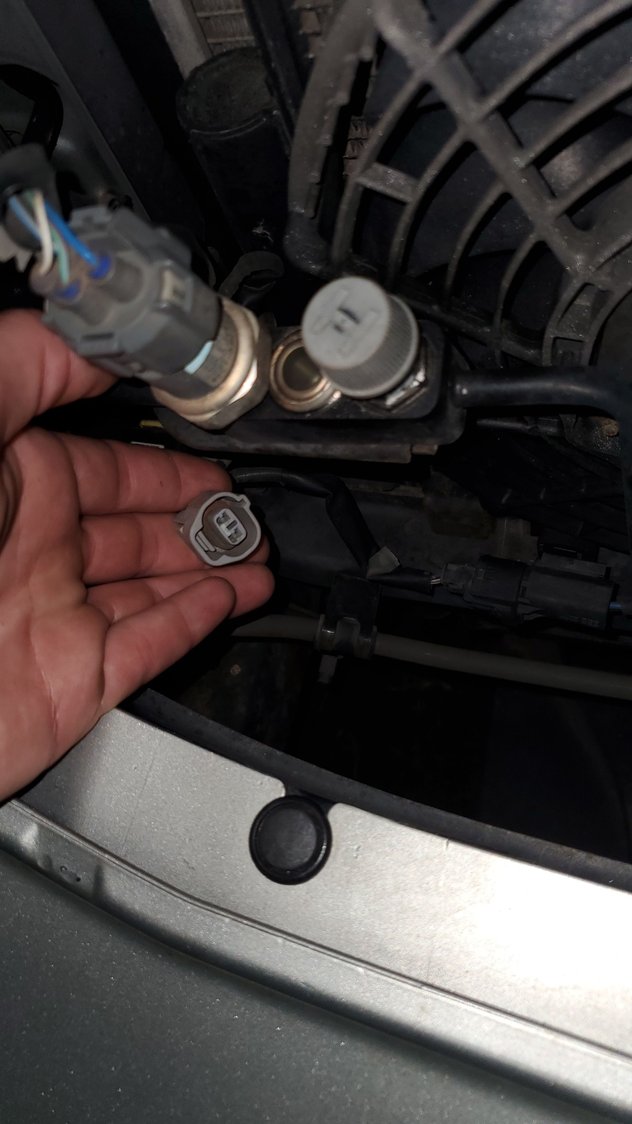

Just bought my girlfriend an 03 gx470 with 201,xxx miles. Absolutley love the truck. Today we got in the car, and started it, while in the parking lot. The A/C was not ice cold, felt as though it was low on freeon, however, once we started driving, it reached normal temperature and got ice cold. We drove to my shop and I checked the pressures, they read 29psi and 135 psi after a 45 minute drive. I topped it off to 39 psi and 190 psi. Since outside temp was 92F and engine was bay was hot. No change, the condenser fan did not turn on. I hooked up a power probe and supplied the fan with 13.1 V, the fan kicked on. Checked the voltage from the harness and the voltage read 0.0, the compressor and everything else function normally. I checked the 20amp fuse, it was fine, I swapped the relay out with a good one, no change. I cannot figure out why the condensor fan is not coming on, however there is a grey two wire connector that is not connected to anything that has a 13.1V current. I am at a loss and any ideas would be greatly appreacieated. Lmk what you think.

That loose plug is “standard”....confused many owners here...might have something to do with trailering options....has nothing to do with your AC issues

It's rare for me to notice the condenser fan come on. Since the fan comes on when you supply power, it's good. And since you made sure the refrigerant levels were correct (like many modern cars, the GX is sensitive to having the right amount in the system) it's good.
I think you're seeing normal behavior.
No one knows what that extra connector is for. My theory was that it was for headlight washers, but if it's a constant 12v with the key on that's obviously not true.
