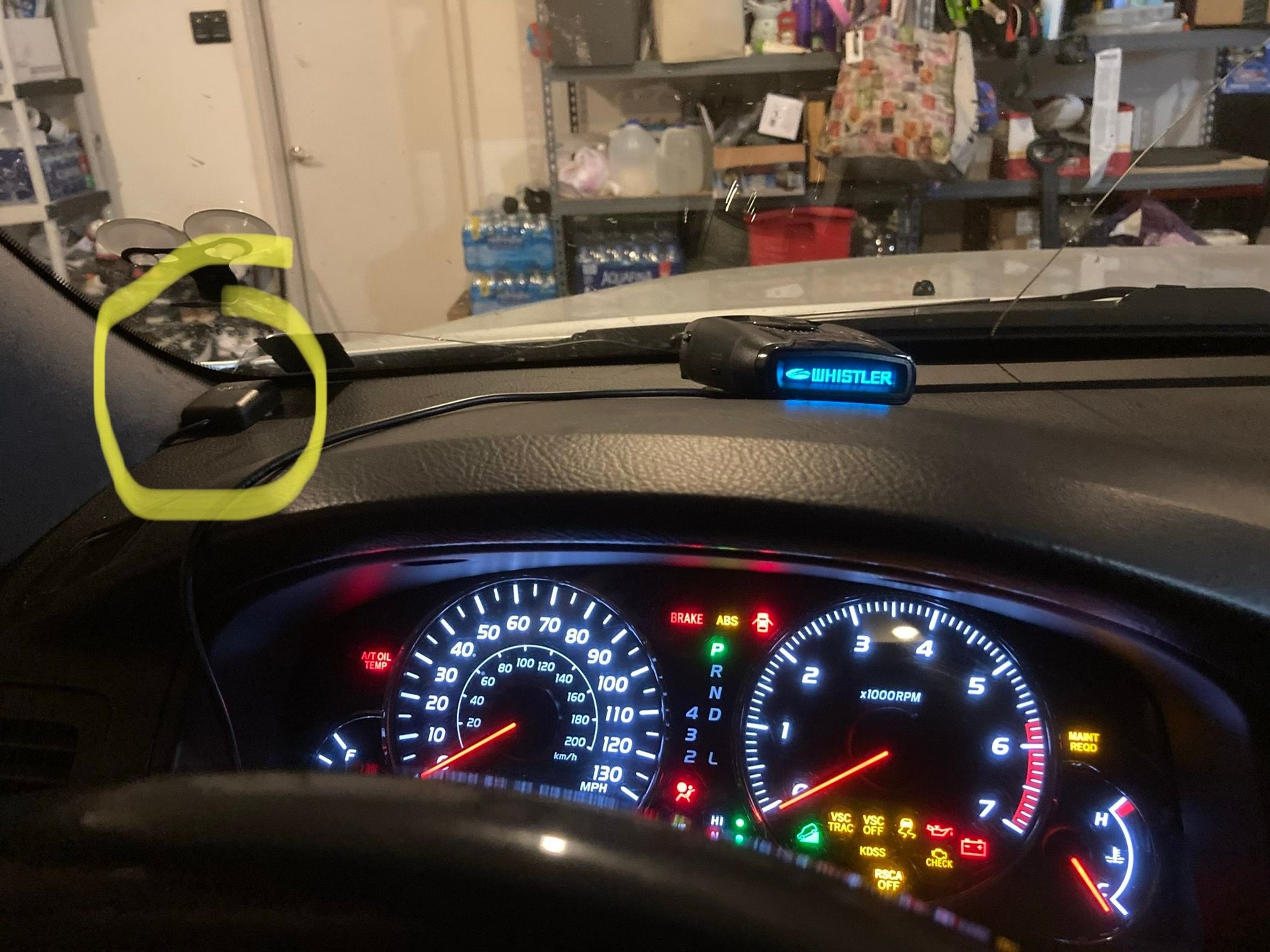

I used and installed the GOshers blond spot monitor system.. pretty easy to install about 2 hours all you have to do is snake the harness kit along the drivers side door and splice about 4-5 wires into your existing turn signal and reverse lights.

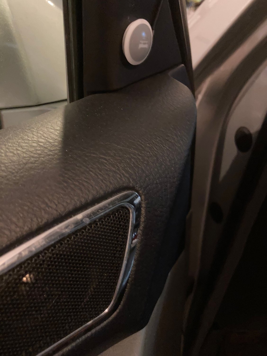

i placed the GPS sensor on the top left corner of the dash, indicators near the side view mirrors and there’s a alarm mounted on the bottom of my steering wheel.

Indicators

GPS
