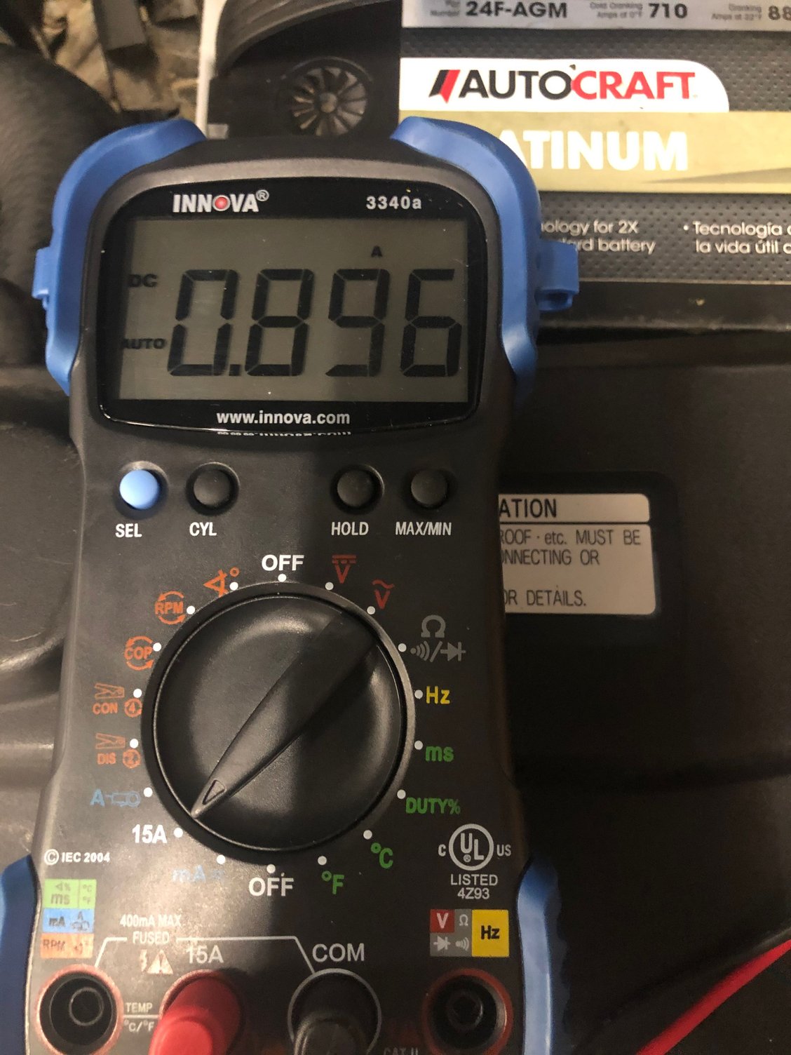

Hello all! I have a slight power draw on my 07 Gx470. As of now it’s not too big of an issue. The lowest it’s got after sitting for about a day and a half is 11.8v. Battery is pretty new. Installed over the summer. Passes a battery test. Alternator was installed at the same time and is charging normally. It’s going to start getting colder here and I don’t want to wake up to it not starting. Any known issues with these? Also I have to get a multimeter. Any recommendations? I don’t need a high end one but don’t want a crappy one either.

I’m looking at .89 amp drain. I’ve seen a few numbers that there should be no more than a .5-7. Is this something I should worry about?

I followed it. The max milliamp the tool will read is 400. When I set it to milliamps I don’t get a reading. When I set it to 15A that when it reads the .89.

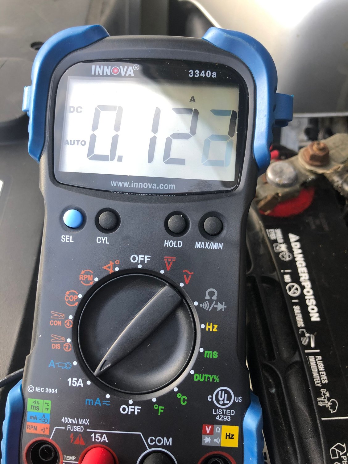

Started pulling fuses today. Pulled the 30A radio fuse and it dropped the draw to .122A. So the culprit has been found but I’ve got to figure out the next step cause I need the radio.
