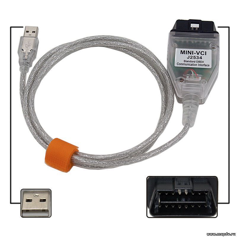

Old Mar 8, 2019 | 12:33 PM
mapdv's Avatar
mapdv
Joined: Dec 2018
Posts: 31
From: SPB
Originally Posted by rjking2112
3) If anyone has specific links of where to get the software and recommended cables, that is much appreciated.
To buy an original or Chinese clone, use the phrase "j2534 adapter" in the search. I use a Chinese clone-it works. Link - https://ru.aliexpress.com/premium/minivci-j2534.html?SearchText=minivci+j2534&d=y&tc=ppc&initiative_id=AS_20181129031743&origin=y&catId=0&isViewCP=y
