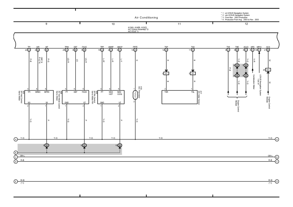

The actuators are stepper motors and they report their position back to the A/C ECU, so if they're reporting the "wrong" position, the ECU will command them to move to the "correct" position. I would pick the one that easiest to get to and replace it to see if that solves your problem.
(Image from Autozone repair guides)

Thanks for the response. Are you saying that one bad actuator (stepper motor) could make the others malfunction as well?

No - it's that you sound unsure this is the problem, and this is a way to test your hypothesis without going crazy with the credit-card. Fix one - if the sound diminishes, the others are likely bad too and you can proceed with their replacement.
