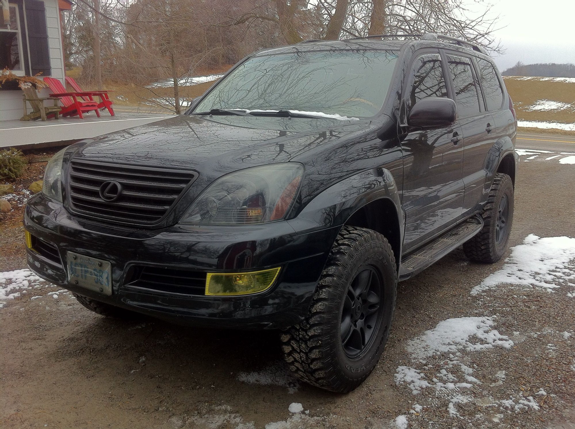

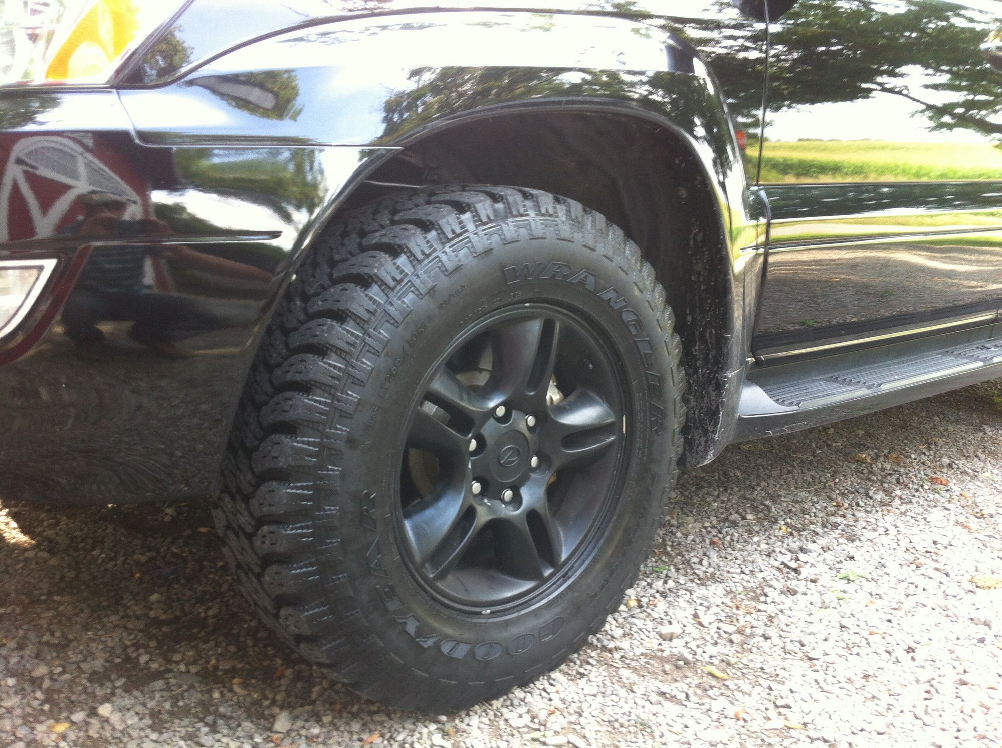

A 265/70/17 tire will not require a lift. If you are looking to keep things "simple" start with that and see if you get the look/stance that you desire. My truck does not have kdss so I'm not able to offer advice directly relating to yours. If you do decide to lift it there are several options for the front. If your factory shocks are in good condition they can be retained so you don't loose the adjustment option. Either spacers or a spring swap can be used for a 2" lift on the stock shocks. For the rear there are slightly less options available. I opted not to trick the airbags either. I tried it, hated the way it drove and almost immediately after switched to a custom made spacer under the airbag. I'm currently running 285/70/17's with 3.5" lift. This is as large of a tire you can run until you're into serious modifications. Do a search and you will find that all these topics have been discussed in great detail. Do your own research on what works with the kdss. I personally have no idea.
This is a 265/70/17 with no lift.
This is 285/70/17 after the lift.

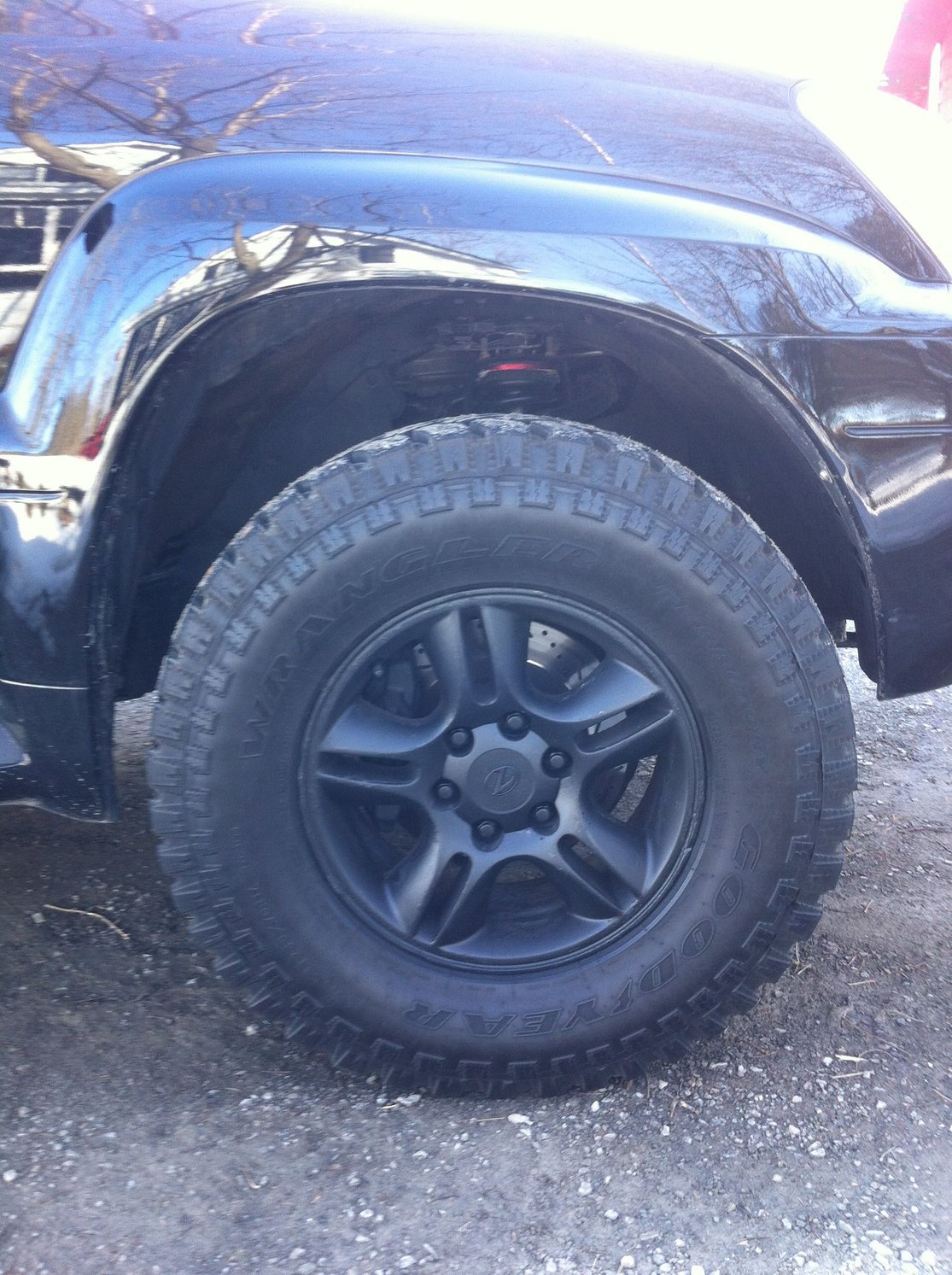

Yes, back in August. Here are the results with 285/70/17s
