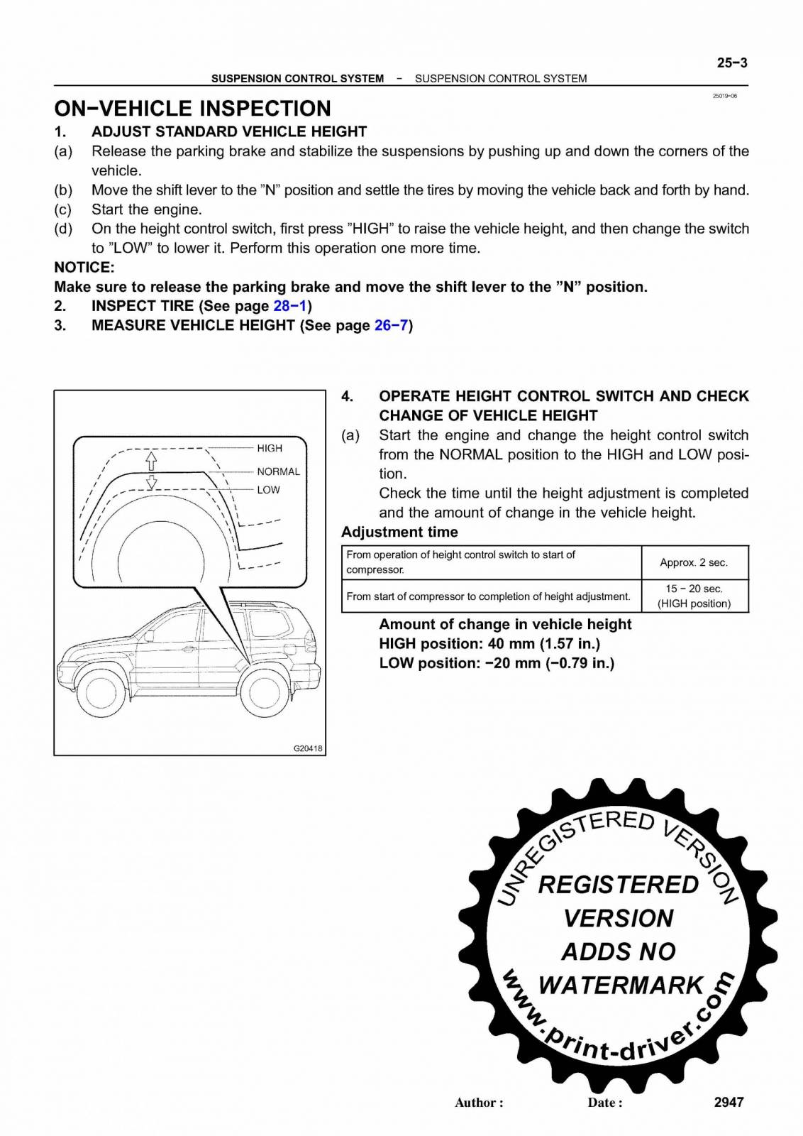

I don't think that I have a sensor issue with the air suspension ride height. the system operates normally in terms of moving up or down when I use the button. the ride is smooth and comfortable. it's just that no matter what the setting is, the left side simply sits 1" higher than the right. Is there a way to reset this or is there something else that needs to be done? Thanks,

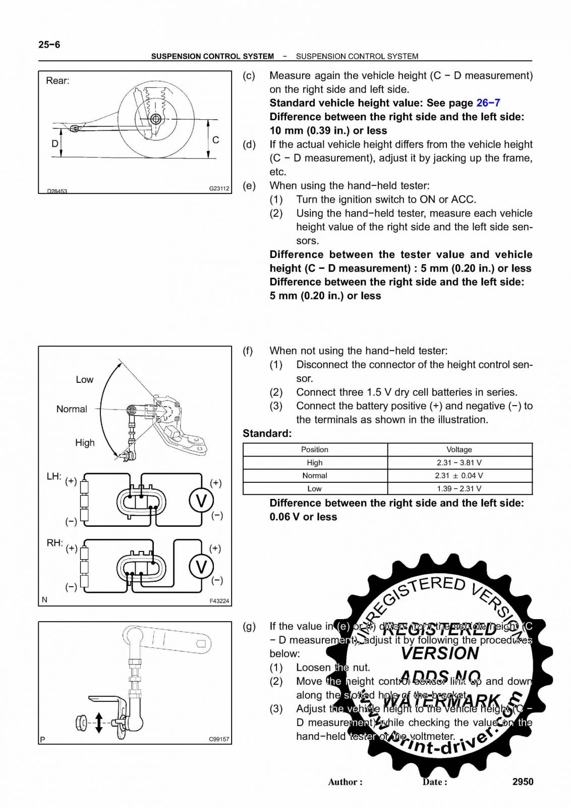

Sadly, i do not have the part shown in the diagram. I have attached an image of my control arm looking bar.....

Greg you are looking on the wrong side, the Height Control for the rear is on the Right Side. Have a look and let us know.

I think I made some progress. I did find the sensors finally, sorry for being slow on that. the driver's side, the one that was higher was adjusted to all the way up (diagram p-below). the other side which was lower, was set to the middle. I dropped the driver's side down and it seemed to help some but it also somehow lowered the other side, though I didn't touch that. So, the best I could do so far is to move the driver's side all the way down and move the other side all the way up. That brought my gap difference down to about .5-.75" difference instead of 1".
However, I am wondering now if I needed to jack up the rear end, pressed the "off" switch, lower the vehicle, then allow it to settle itself? Also, the diagram is a little confusing to me, perhaps I should have gone "up" on the bolt adjustment to lower? Sorry for all the questions but i really appreciate the guidance.
