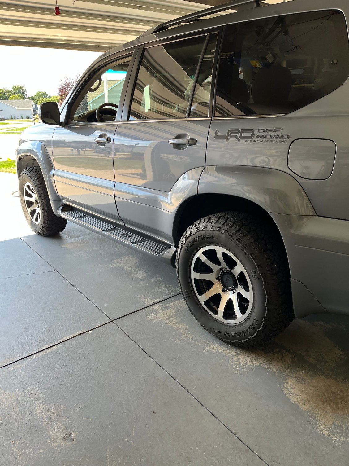

Damn getting old sucks. Just typed this twice and then somehow deleted it. 3rd times a charm. Photo is of Bob. Bob is the affectionate name given to him meaning Big Ole Boy. Bought him 3 years ago with 92K and already up to 107K and he has been a perfect gentleman. Did the air bag delete with these
Bilstein 5100 Series Shock Kit for Toyota 4Runner 4WD 2003-09 - Includes Front Ride Height Adjustable Shocks # 24-239370 & Rear Shocks # 33-18717"><span style=Bilstein 5100 Series Shock Kit for Toyota 4Runner 4WD 2003-09 - Includes Front Ride Height Adjustable Shocks # 24-239370 & Rear Shocks # 33-18717" /> Bilstein 5100 Series Shock Kit for Toyota 4Runner 4WD 2003-09 - Includes Front Ride Height Adjustable Shocks # 24-239370 & Rear Shocks # 33-18717">Bilstein 5100 Series Shock Kit for Toyota 4Runner 4WD 2003-09 - Includes Front Ride Height Adjustable Shocks # 24-239370 & Rear Shocks # 33-18717
And Unity | 30-563000 springs. This was recommended on the forum as a conversion kit.
I Have enough adjustment to lower the fronts (I think) about 2 inchs. I want to change the rear shocks & springs to shorter ones by the same 2 inchs. Can anyone give me a number that will do this. Just need to be able to climb in it a couple more years or it’s going up for sale.
