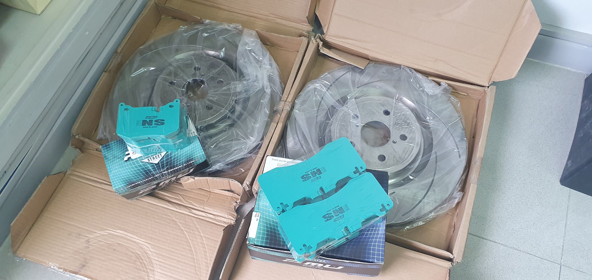

I'm in the same dilemma as you.
I bought new rotors and pads from Project Mu.
My braking is really bad and when I went into the workshop, the mechanic showed me my pads and they had 80% life in them. So my rotors are not up to par after the dealer faced them back in 2019.

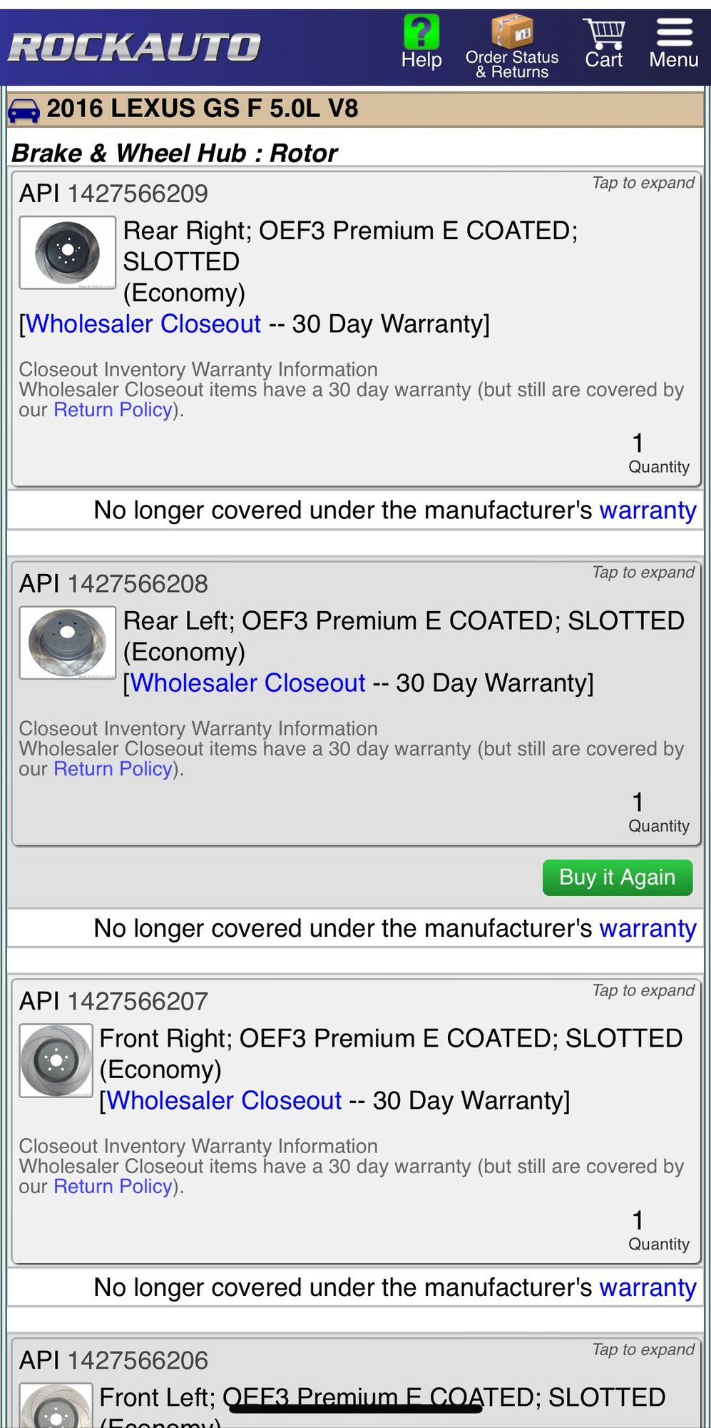

For good quality aftermarket rotors with all the same features as OEM, go to Rock Auto. That's what I did, and I have a full set sitting on the shelf for the next brake job, that's how cheap they are. As they should be.

Never resurface these rotors. They're not thick enough to waste all the metal resurfacing takes. I literally slap new pads in and bed them. I never turn rotors anymore.
I have a pair of centric rotors from Rock Auto along with new PM NS pads waiting.
You think I should go ahead with the rotors and use existing pads?
I haven't ordered the rear rotors for some reason... I think I will do that today.

I did the same. I found these and bought the rotors for all four corners mid 2020 for under $150. I found brembo pads and sensors another time so I’m ready to go. Mine is a garage queen so some day I might need these.
