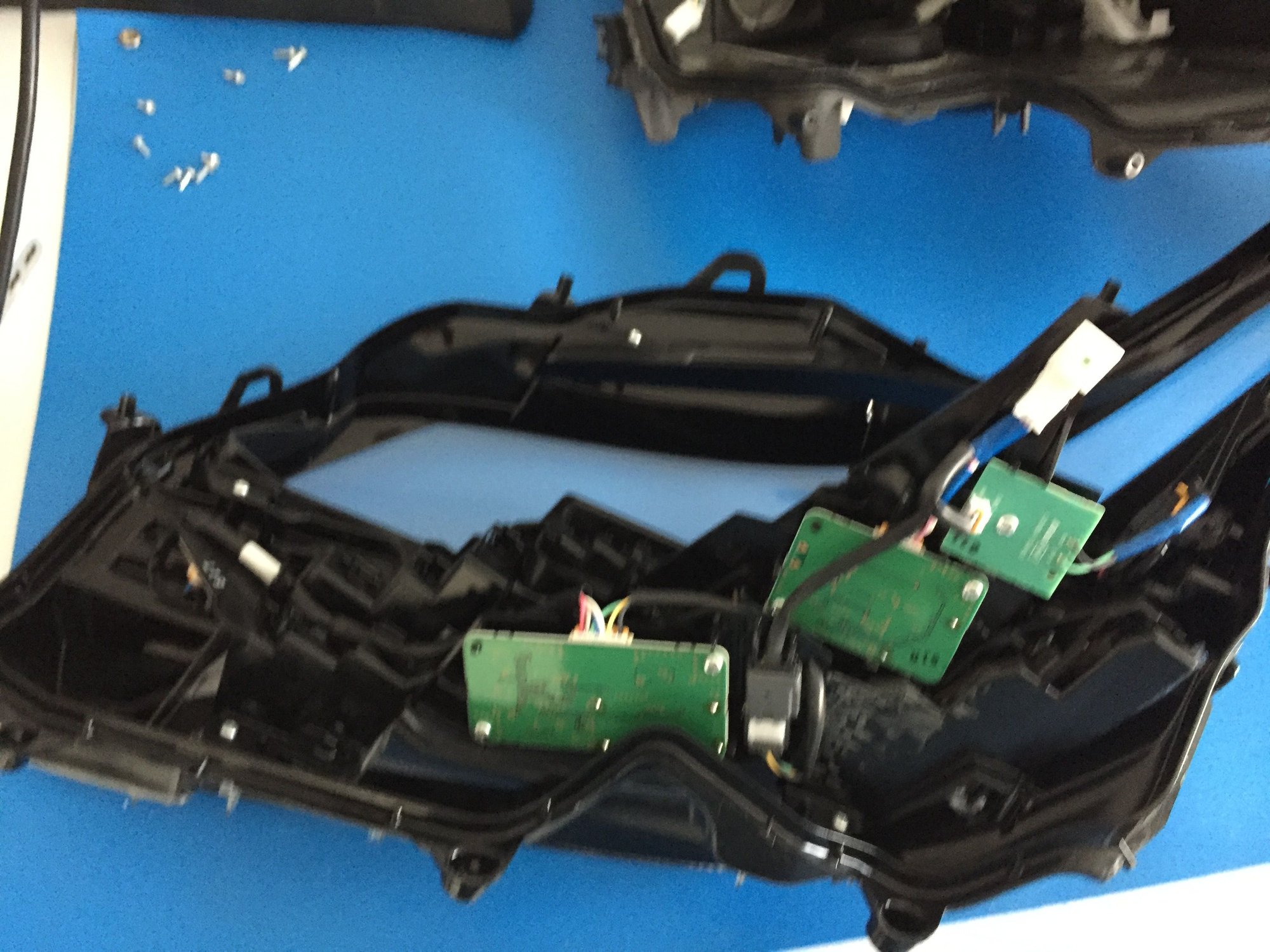

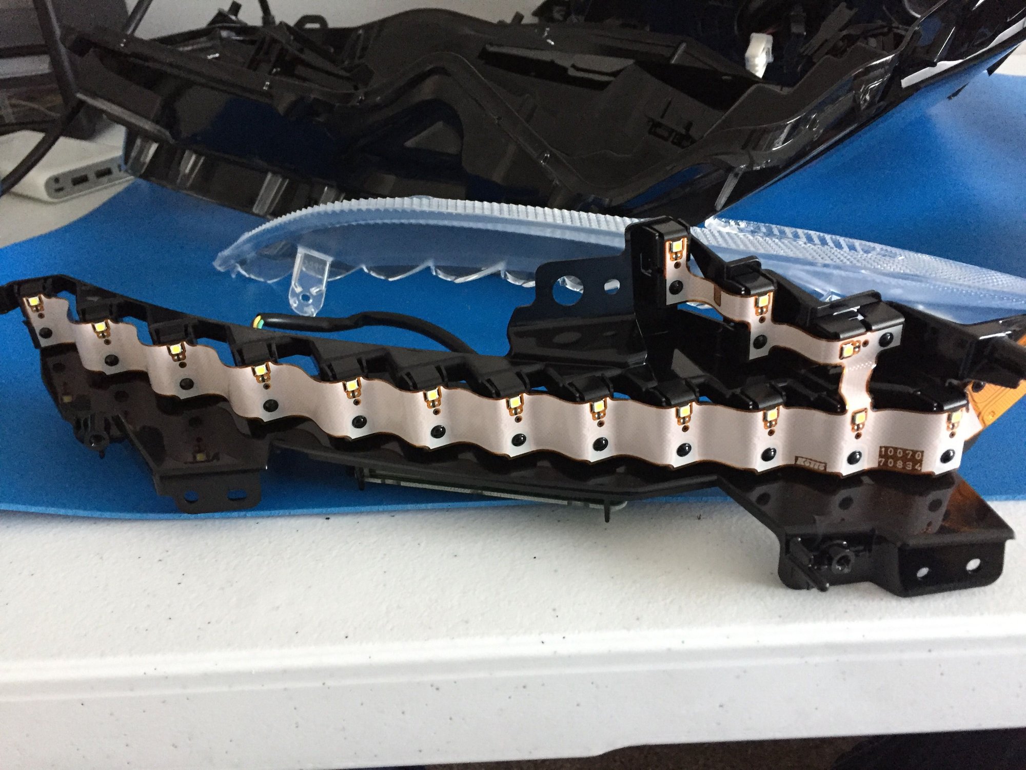

Lucky for you these headlights aren’t sealed with perma-seal, which is a pain to work with to open up headlights. The LEDs are SMDs on a ribbon cable however if moisture got in, the LED driver is more likely the problem. You could probably buy a salvage and swap the LED driver, it’s a small circuit board fastened by screws and plugs into the LED array and the headlight ECU.

Awesome information, thanks so much - exactly what I was looking for. Question - are the DRL LED's managed by the headlight ECU/Ballast?
I'm wondering if mine is fried. All other functions (headlights, high beams) work normally.

All power for the headlight goes through the headlight ECU. It provides power to the LED driver inside the headlight. The ECU is not inside the headlight, it's a water tight module just outside of it. I would hope it's not the ECU.
