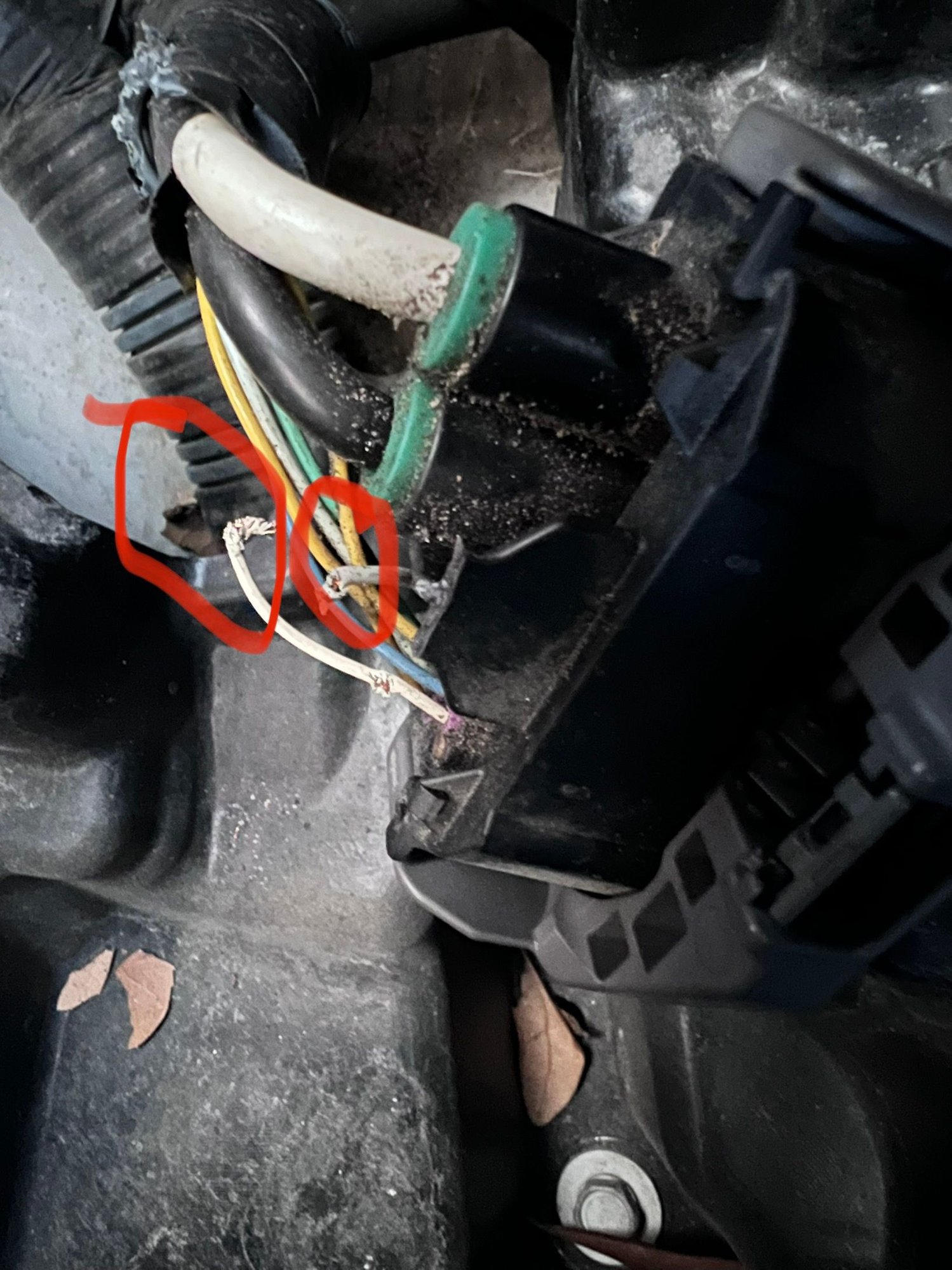

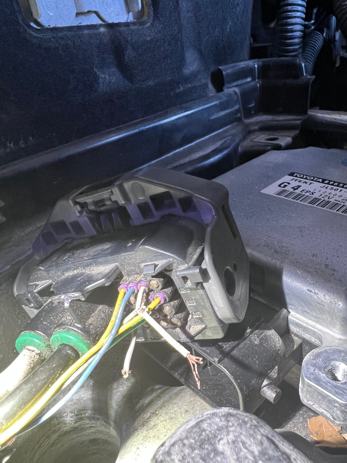

Well.. this is what I found by the power steering ECU. Trying to eliminate the vermin which seems to be the root cause, but what do y’all suggest how to wire this? It’s an extremely short length to the connector and I’m not of a mechanic than an electrician. Any advice would be appreciated!
I've soldered wires into encoder d-sub connectors. What you have there is an easy job for any electrician friends you may have.
For everyone else: Just cut that nub coming out of the connector where it's gnawed, cut to the other end where it's gnawed, slip on heat shrink (important!), then solder in an extension. Slip the heat shrink on and heat it up with the wife's hair dryer then take her out for a milkshake.
I'll be honest though, that ABS sensor wire break looked a little more like corrosion to me, but who knows what nasty crap they have in their mouths that'd oxidize copper.
Definitely get rid of the mice though asap. Poison works but then they die off somewhere and stink up the place sometimes. Traditional traps with peanut butter in the fulcrum works well... but crickets also like to eat the peanut butter out of the bait bin IME.

One of the wire is really short, maybe 1.5 inches long. I’m not an electrical person and don’t trust my soldering skills. What are your thoughts on using a t-tap and covering the opposite hole with liquid tape?
Temporary, sure. That'll get you to someone's house to solder it properly/troubleshoot your issue.
Anyone know what kind of pins/connectors these things use? Maybe he could repin and new wire in and swap it out and not have two solder joints?

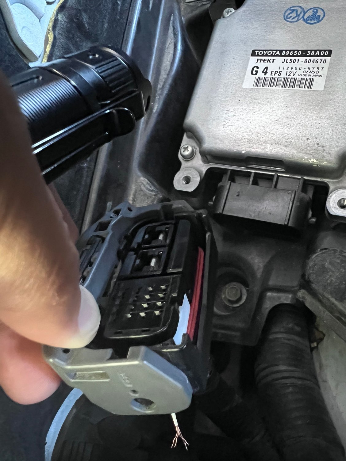

I opened the white tab on the harness and heard it click. I’m not sure if I just need force to take it out due to the purple waterproof seal or if there is something I need to do on the male end (although there’s no indication) to release the pin

Have you looked up the part to just how you can just replace it the correct way? Maybe you can find it used? Or is it built into the main cars wire harness? If the cost is very high could you make a Insurance claim depending on the cost?

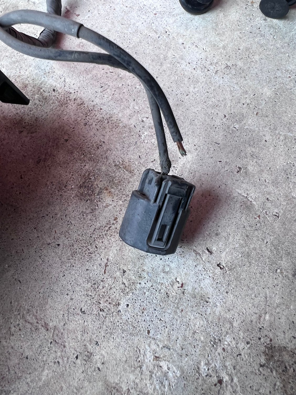

I’ve tried to look for it, but to no avail. I suspect it’ll cost around $300 which is less than my deductible. The sleeve is wrapped with a bigger sleeve which I assume is the the main harness, so passing in that as well.
I wanted to de-pin it to do a cleaner job, but worst case I can use a t-tap and run the wires that way. I’d rather not spend 100’s if it’s not necessary lol.
Also, found this on eBay, but this harness plugs into the opposite side of the ecu.
https://www.ebay.com/itm/26486083293...mis&media=COPY

Yes that would be shipped from overseas and it's opposite side driving. Try car-parts.com. Also hit up some of the ebay seller that show wrecked GS pics, and ask if they have. For sure you can find it off a wrecked car on car-parts.com, just find a wrecked model and ask. Also look for someone that has a used Steering ECU. They had to take that harness out of it.
You can possibly repair it, but for $100, I would get a new/used part.
