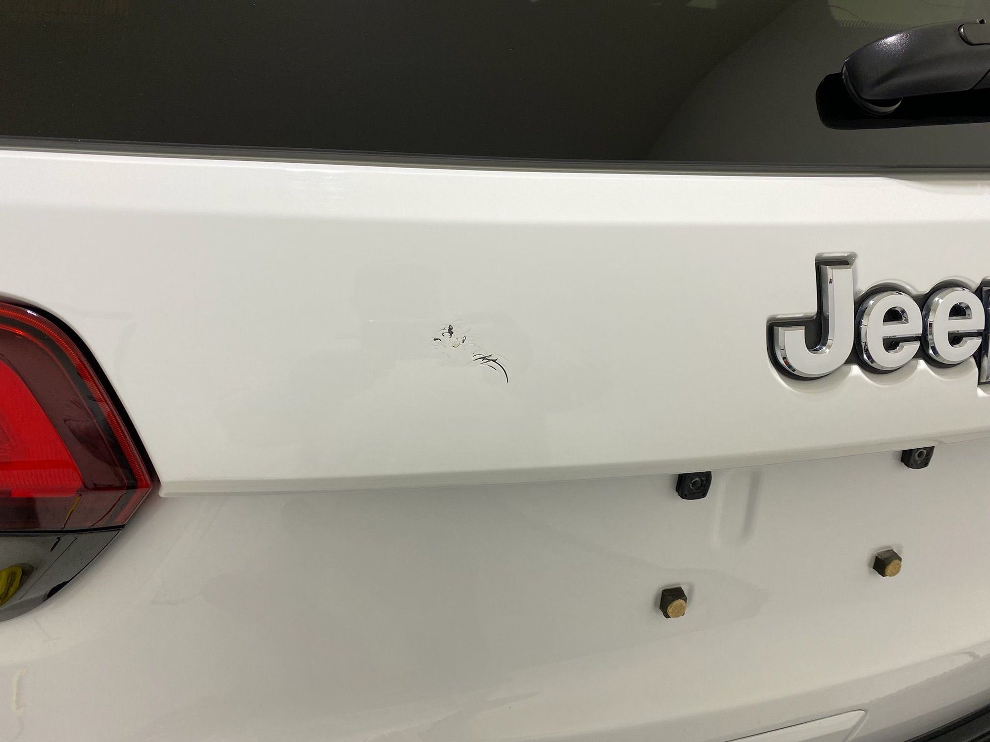

Careful with that Griot's polisher Chin. My friend bought one of their polishers last year and it flew apart on him 2 days ago. The head came off and he gouged his paint. Probably a fluke but the damage was pretty bad on his rear hatch and has to have it repainted. He was not happy to say the least.

Whoa... first time I've heard about that. But in all fairness, since getting mine in 2018, I've used it maybe a dozen times. Since I've been teleworking more than 50% of the time and the GS is garage kept, the paint's been in great condition and I haven't had to polish in the last 2 years. Maybe it's wear and tear?

He just bought the buffer last year from Griot's.

He should be able to get that exchanged... IIRC that yellow part is hard plastic and should not have failed... unless it was defective... it happens. Did he try to get a replacement?

Why would he every use that brand of pad again after this experience?

it’s not a pad, it’s the backing plate. The pad is attached to the backing plate with velcro.
