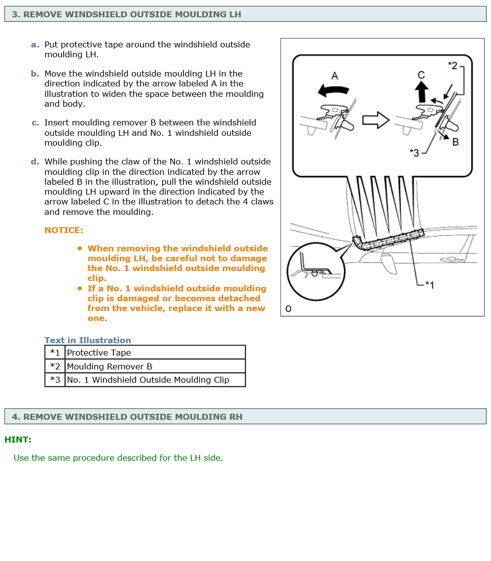

Is the black trim directly next to the external windscreen replaceable?
Mine looks worn out, i think the previous owner parked it outside often.

Thanks for that. Do you know if its a difficult install? Do they just pop off, or does the windscreen need to be removed.

Pretty sure they pop off. I'll check the factory manual and confirm. Just make sure you go genuine.

Old Jul 31, 2020 | 03:59 PM

Excellent, thanks for that! Is that from a service manual?
Looks to be pretty straight forward, except for the remover tool.
Yeah, service manual
Don't worry, Toyota have an SST for wiping their own nose and feeding the cat.
