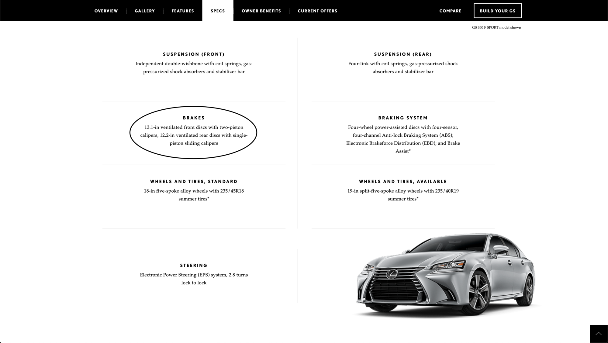

On the Lexus Stevens Creek parts website look at 'Vehicle Fitment' and click on '23 more fitments' and you'll see that brake caliper part numbers 47750-30560 & 47730-30560 are shown to fit both the F-Sport and non-F-Sport models, not just the F-Sport model. That's what all the Lexus parts websites show, which I now believe to be wrong.
Old Mar 5, 2020 | 08:53 AM
  #81
chrispy's Avatar
chrispy
Moderator
iTrader: (21)
Joined: Sep 2005
Posts: 5,767
Likes: 84
The F-Sport caliper that uses the 14" rotor is visually different from the non F-Sport caliper. You can tell it's a larger caliper just by looking at it. The non F-sport caliper is the same as 06-11 GS350 RWD and 06-13 IS350 RWD.
Old Mar 5, 2020 | 09:01 AM
  #82
bclexus's Avatar
bclexus
Joined: Nov 2014
Posts: 13,614
Likes: 2,918
That's good to know. So, after chasing incorrect and misleading Lexus parts websites it's almost certain that the F-Sport does indeed use a different front brake caliper to accommodate the larger 14.0 inch brake rotor.
The answer to the question 'Do All 4GS Models Use The Exact Same Front Caliper?' should not have been such a mystery, but sadly it was because of incorrect Lexus parts websites.

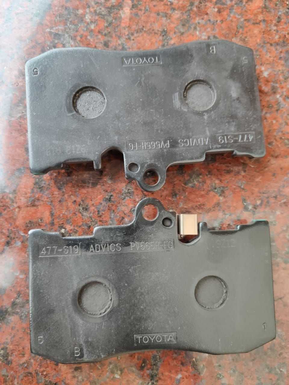

That's correct - #04465-30470 has been replaced with #04465-30510. I wish I knew why the replacement was made, who made the replacement (Toyota/Lexus or the pad maker), and what the difference is between the two brake pads. Three questions we'll probably never know the answers to.
Apparently 04465-30510 is still being made by Advics.
Also it is compatible for 3GS too.
Even the codes in the pad "477-S19" "PV565H-FG" are still same.

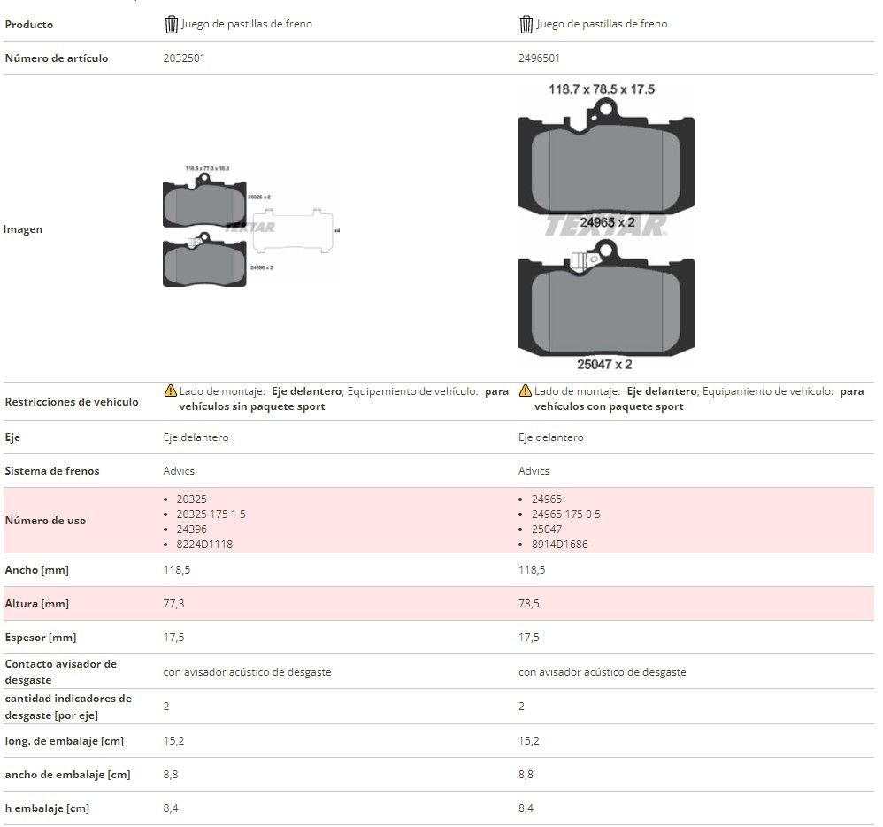

Definitely all 4GS models use the exact same front caliper or not? I have 2013 Gs450h Luxury and my rotors are 14 inch. (I assume the previous owner would replace the brakes with the F-sport ones.).....
Textar pads references are: TEXTAR 2032501 for non sports models and TEXTAR 2496501 for Sport models.....
TEXTAR 2032501 heigh is 77,3 and TEXTAR 2496501 is 78,5......
And here my car with Jurid Rotors 562949JC-1 rotor(Jurid says that 562949JC-1 rotor is compatible with LEXUS (43512-30371), but Jurid 562949JC-1 is 13,1 inch and Lexus 43512-30371 is 14 inch, which makes me think that the sport version (14" rotor) could have the same caliper as the non-sport version (13.1" Rotor)....
My mechanic told me that he didn't mount the rotor for me because being 13.1" it wasn't compatible with my car (14"), but if the caliper of the 14" sport models is the same as that of the 13.1" non-sport models then maybe he could install it, right?
And here my 14" Rotors:
Old Feb 8, 2022 | 12:46 AM
  #90
peasodos's Avatar
peasodos
Joined: Feb 2017
Posts: 5,522
Likes: 2,264
From: USA
Originally Posted by bmwjavier
hi,
The caliper could look exactly the same, but the mounting holes could be in a slightly different position between 13.1" and 14" rotors.
