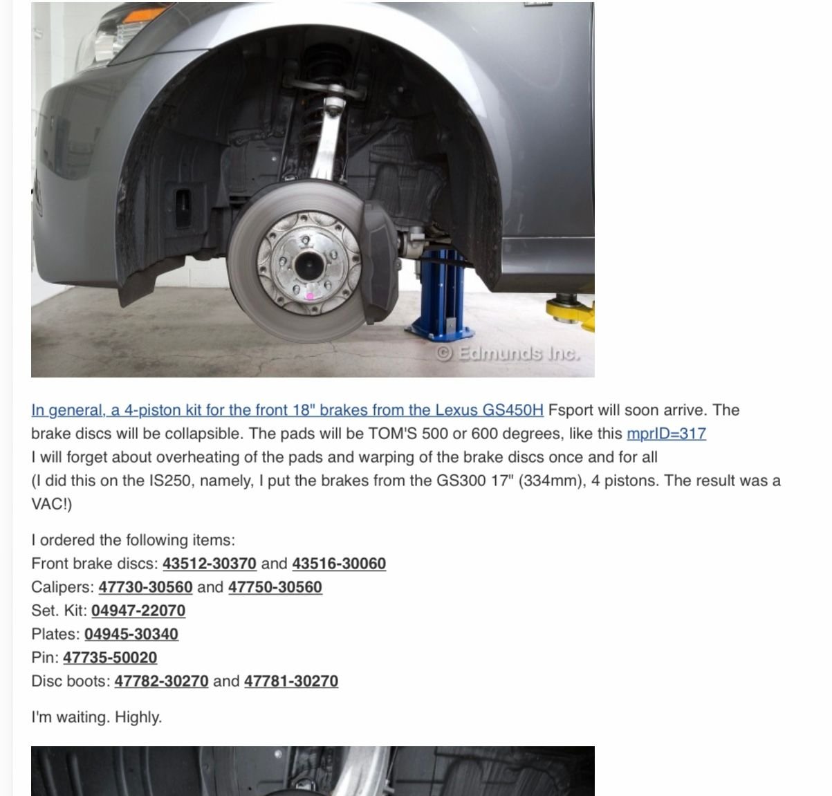

heres a example from a person who installed them on gs350 awd. Page translated in chrome.

Front GSF brakes are also bolt on on the GS.
Except the dust shields. They dont fit.
also from negatives they are heavier ( rotational mass) and can impact acceleration.
