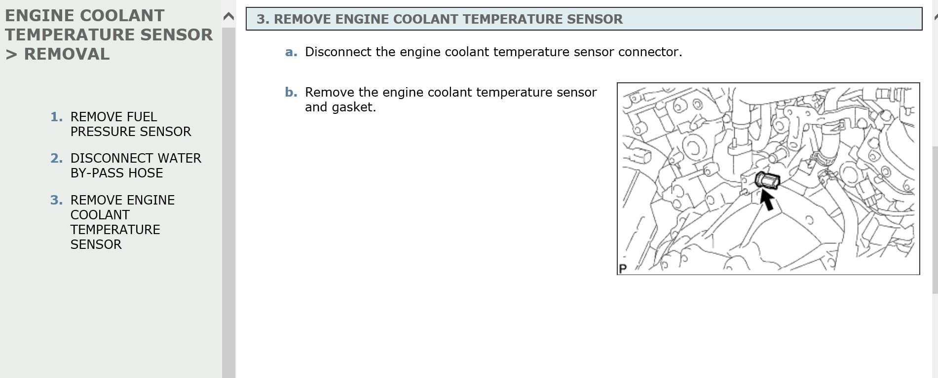

I'm planning on installing a coolant temperature gauge and need to find a location for the 1/8 NPT sensor. I was planning on using the block drain plug, but the size is BSPT 1/4-19 and is going to be too small for an adapter for the 1/8 NPT.
Anyone have a suggestion on where I can put the sensor? Ideally somewhere in the block to measure coolant temperature inside the engine....and not a hose that will only see flow when the thermostat opens.

Maybe you can get a fitting to replace the original sensor that will accept two sensors.
It's difficult to tell from the crude drawing, but the sensor appears to be near the bellhousing.
Thanks for the idea, but I may have spoke too soon. I found an adapter for the 1/8 NPT sensor to fit in the block drain port. I just assumed it was too small but that's what I get for assuming.
Unless the sensor is put where the coolant is free-flowing it might not give an accurate reading. Putting a sensor in the block drain port, it may be somewhat shielded if it doesn't protrude far enough into the coolant passage.
