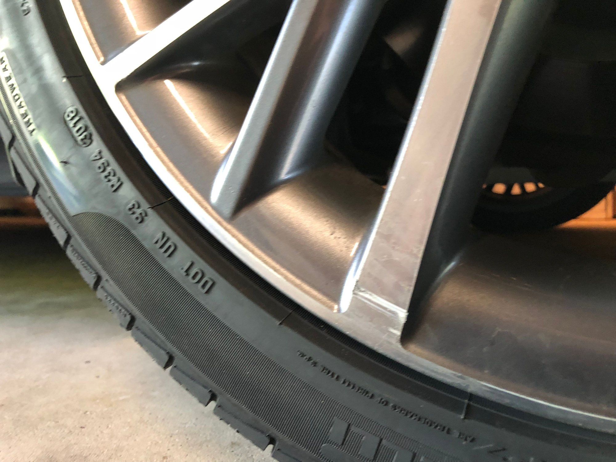

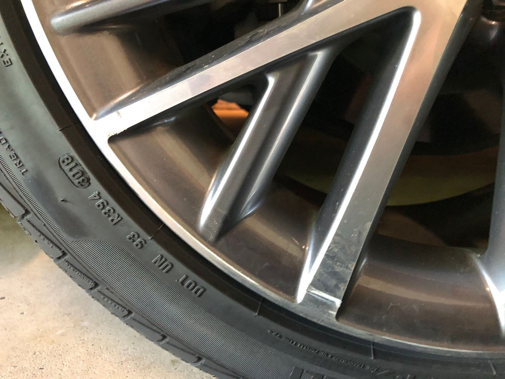

Had my new Pirelli tires installed on my GS today and when I picked up my car I noticed all 4 wheels have scraps at the same spots and same distance from the edge of the rim. I immediately went back in the shop and got the owner to look at it and he immediately said they didn’t do that. It got heated between us because I know these scraps were not there, I just bought this car a couple weeks ago and now every little blemish on the entire vehicle and I am 100% positive they were not there when I dropped the car off. Looking for feedback on how everyone would handle this.

I see that you added some pictures of your wheels in your original post. Are the white marks I see on-top-of the wheel's finish? It appears that 'if' the white marks are material that was added to the wheel's finish that maybe those marks can be removed without damaging the wheels.
The scraps are into the metal and deeper than they appear on the images, the pics don’t do the damage justice. It may be possible on some of them but a couple a pretty deep.

That damage might cost more than you think due to scrapes on the machine finished parts. I learned this week on my other car that machine finished wheels cost significantly more to repair. A good shop will need to put the wheel on a machine lathe to be recut with a diamond bit in order for you to have the shiny finish with the machine look lines. I was quoted from $100-130 per wheel to fix machine finished wheels. The cheaper way would be to sand, fill, and paint but it won’t have the reflective look anymore.
I would continue to pursue the tire shop to have them cover the repair. Good luck.
