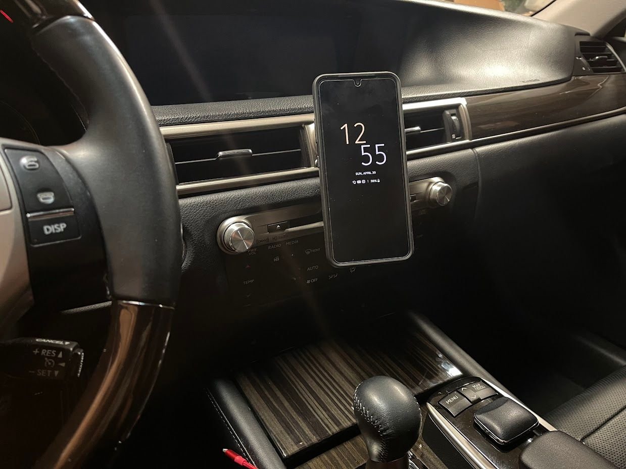

The clock on my car still works but I just blocked it entirely. Most phones these days have always on displays that show time which I find is easier to read.
