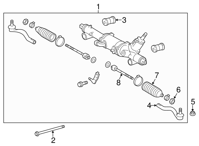

Originally Posted by eddie420
You need to look into the gear assembly, P/N 44200-30770.
44200-30770 - this is the complete steering gear assembly. I need only the detail in your drawing No. 8
Old Mar 22, 2018 | 05:33 AM
eddie420's Avatar
eddie420
Joined: Dec 2017
Posts: 2,001
Likes: 680

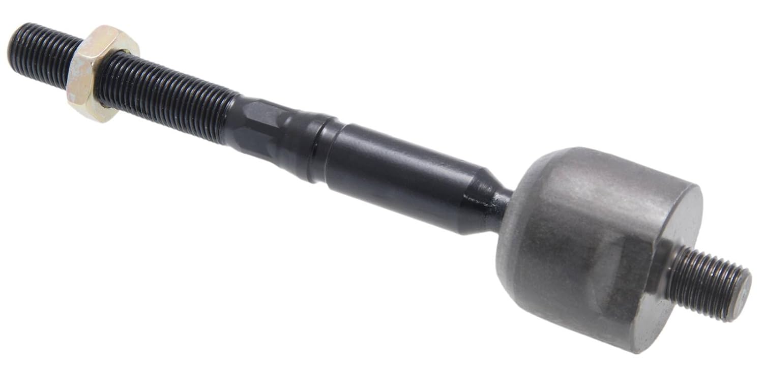

I have a 2012, GS4, bodywork GWL10
on your photo from the previous body. They do not suit him, they are different.
On the previous body carving with both sides of the M14. On the last body on one side of the M14, on the other M16
оn this photo my RACK END
