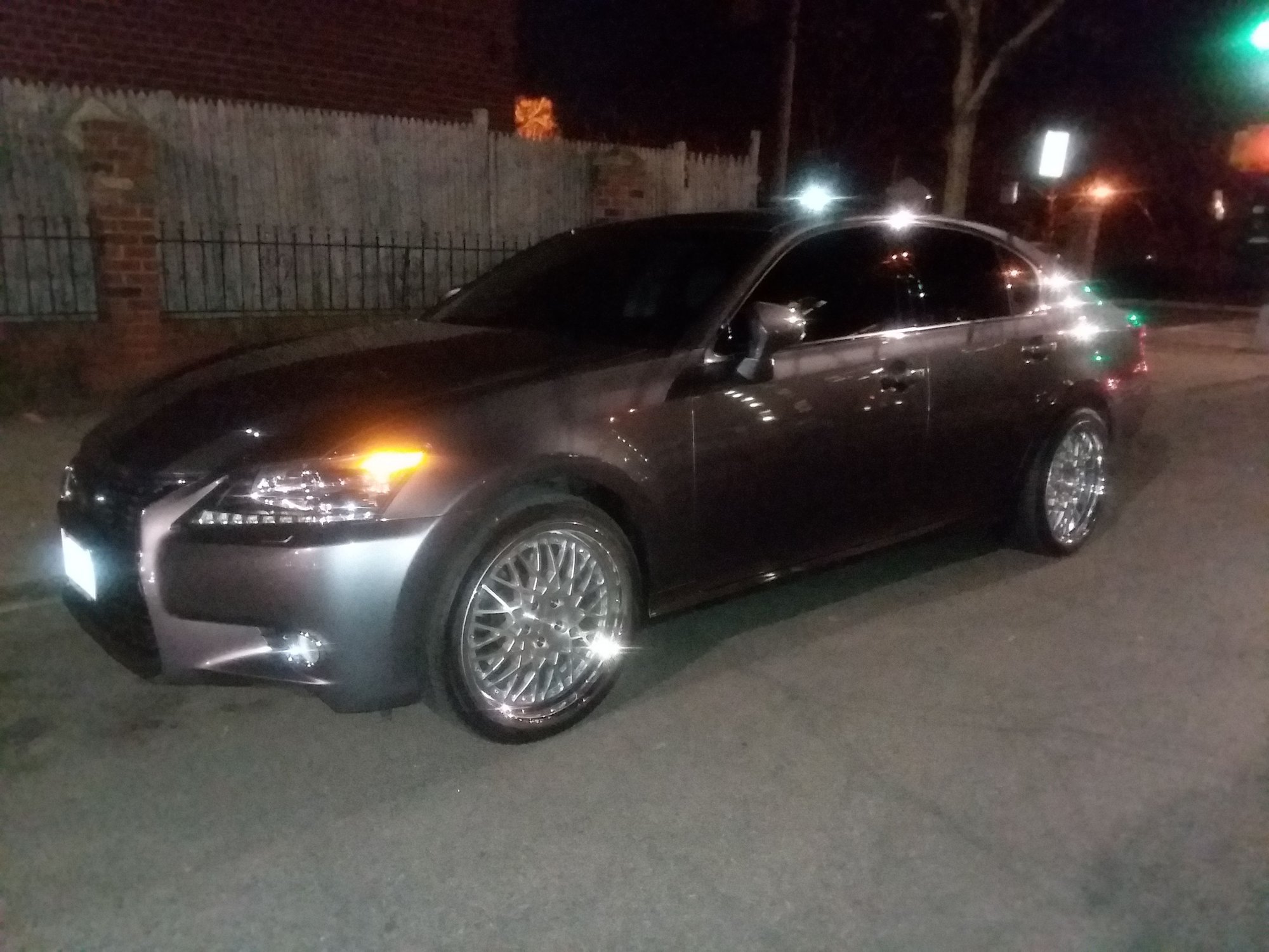

Sorry for the late response, thanks a lot timmy0tool, Twidge, mikesd1980 for the comments the is actually riding nice and I been swerving potholes no matter what state and no matter if its rims or factory wheels im a NY driver that loves NJ DRIVE the movie so act like you know. Here is a pic of my baby
