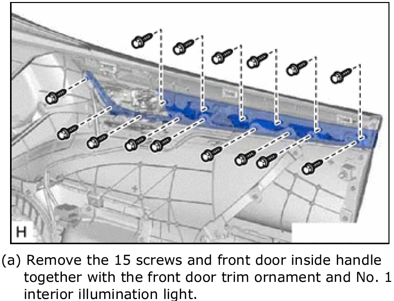

You have to take the door off (3 screws only) and then take off about 15 screws (it's really more like 18). Here is a picture of when I did a swap of my GS350 trim with the GSF trim.
Back of the Front Passenger Side Door
Back of the Driver Side Door
Here are the screws you need to remove for clarification. The light strip is attached to it.
