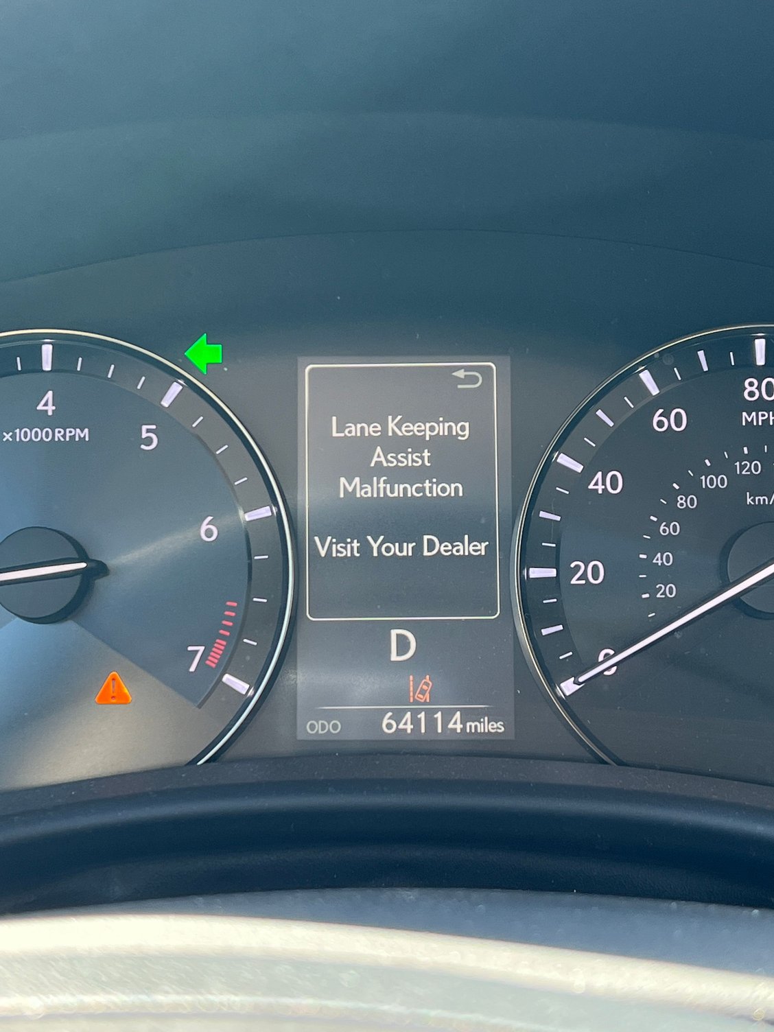

My 2016 GS350 recently started displaying an error when I attempt to activate lane keep assist (I generally keep the feature off).
Dealer states the "steering vibration ECU" needs to be replaced and quotes $1267 for the job.
Anyone have experience with this? Is that a fair quote?

Do you have the actual code or error you get?

@sbowden99 - Your Code C1A74 references the 'steering wheel vibration' feature, but can be caused the vehicle's wheel alignment or suspension system, with common causes being unbalanced tires, worn or damaged suspension components, or warped brake rotors.
So, the questions are:
Does your car have a vibration or wobble when driving from unbalanced tires?
Does your brake pedal pulsate when braking from wrapped rotors?
Has the car hit a curb or large pothole recently?
Has the car been involved in any accidents recently or had any type of shop work done recently?
No to all above.
And yes, this quote came from a Lexus dealer.
