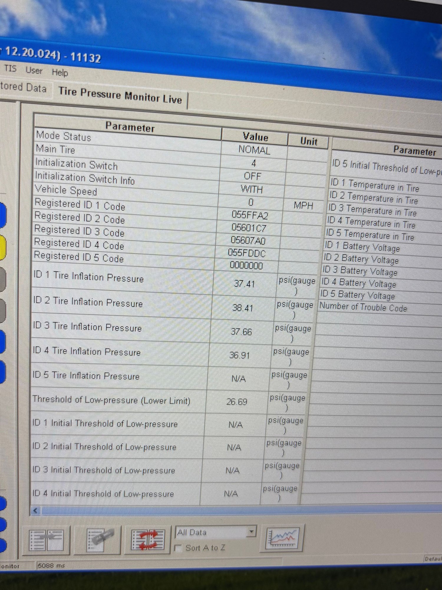

Hey all, I recently had new wheels and tires installed on my GS along with new TPMS sensors. Used a TPMS tool to get the ID’s off the sensors and uploaded them to the car. All is well. I used techstream to confirm the correct ID’s and everything lines up. The problem is that the dash isn’t showing the PSI and shows —. What could be the issue?
I took it for a short 10 minute drive and tried the reset button under the dash. Nothing.
(attached a picture showing the computer reading the sensors)

I installed 4 NEW sensors not even 3 weeks ago, the sensors are being read by the ECU (I checked with techstream and they’re showing the PSI). The issue is the dash still reads —.

Originally Posted by centraxge
Schrader 29112 as then the densos were still out of stock.
I see.
The Shrader 29112's are compatible with GS, but like most aftermarket sensors, they will not display tire pressures on the instrument panel.
Only aftermarket Denso's have full pressure displays, because TMC buys from Denso.
